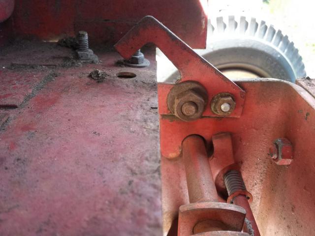

Ed Kennell 45,271 #3 Posted August 28, 2014 Here are a couple pics that may help him Bob. Like you said, the hood brackets have the piece angled down that rest on the 1/4" round rod. I to, leave the belt on the mule drives.....Makes for a quick change if you break a belt. Share this post Link to post Share on other sites

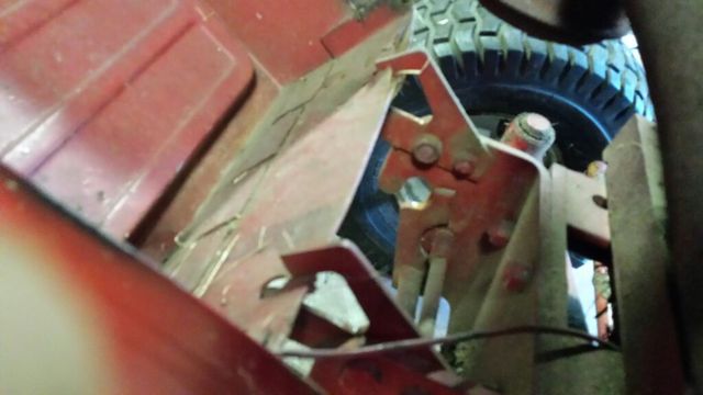

chipwitch 73 #4 Posted August 28, 2014 Thanks Gents. Mine is definitely different. See how mine has a kind of inverted hook? My JD has something similar. That is where a piece of flat stock appears to have been intended to sit such that the hood would be able to rock back and forth. Once opened, the hood can be pulled off by pulling it forward (with respect to the tractor). As you can see, there are just some bolts acting as hinge pins. Share this post Link to post Share on other sites

Ed Kennell 45,271 #6 Posted August 28, 2014 (edited) Yeah , It appears there is a simple piece of flat bar missing on the hood that would fit in that hook and stop the hood at 45Deg. What model C is that ? I have C models '70 thru '80, and I have not seen that. Edited August 28, 2014 by ekennell Share this post Link to post Share on other sites
chipwitch 73 #7 Posted August 28, 2014 Ed, I see you have an 80 C-125. That's what I have. Though, it may be an '81. I have the serial number in another thread. I'll find it and link back. Share this post Link to post Share on other sites
rmaynard 16,934 #8 Posted August 28, 2014 Looks like a C-175 or the like. They had a V-shaped mount according to the parts page. I have never seen one, so I can't comment. The C's I am familiar with have a tab that rest against a rod that runs through the front tach-a-matic hitch. Share this post Link to post Share on other sites

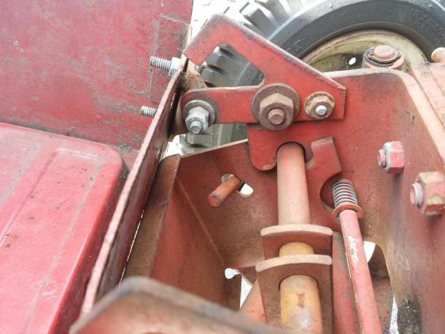

Ed Kennell 45,271 #15 Posted August 28, 2014 (edited) Found it...Wheeeww. Here is what I have on the C-125. The hood drops to the ground, and I have no clue what if anything is missing or how it was supposed to work. That notched piece on the hood is not broken...it still has paint on the edge. Edited August 28, 2014 by ekennell Share this post Link to post Share on other sites
chipwitch 73 #16 Posted August 29, 2014 (edited) Interesting. Ed, yours is significantly different than mine. Somebody must have found the v-shaped part for the c-175 as mentioned earlier, and modified the original. Thanks guys for all the help. Edited: I forgot part of one question... So, are all front mounted implements mounted far enough out front to allow clearance to open the hood? If not, how do you handle the interference, checking oil etc? Edited August 29, 2014 by chipwitch Share this post Link to post Share on other sites

Trouty56 567 #18 Posted August 29, 2014 I have 3 blackhoods....2 have the stops like the OP's...and both stop the hood. The 3rd tractor had none and the hood dropped to the ground as the other example shown. I fabbed up a couple stops because I didn't like that.... Share this post Link to post Share on other sites

Trouty56 567 #20 Posted August 31, 2014 so im confused,is the first one factory or not,not like any of my tractors but I don't have a black hood This is on a 145 auto...The 125 auto is the same..... Share this post Link to post Share on other sites
chipwitch 73 #21 Posted September 1, 2014 Thanks Bob. That is NOT how I imagined it working! BTW, I have the 8-speed manual. I don't see where the hinge is attached to the hood. In the picture of mine above, you can see how it was bolted to it, while yours has a cleaner look. Obviously, the hinge point isn't in the right spot on mine, relative to the hood as the hood doesn't catch on the dog like the one in your picture. Looks like mine was a poor retrofit. Probably not the original hood either. I remember seeing a company sticker just below the tractor's instrument panel... it was some kind of tractor hood company. Probably a salvaged hood from another tractor. Share this post Link to post Share on other sites

Callen 64 #24 Posted September 1, 2014 Looks like the hood is falling down below the catch. Might try bigger bolts in the pivots. Share this post Link to post Share on other sites
Trouty56 567 #25 Posted September 1, 2014 Thanks Bob. That is NOT how I imagined it working! BTW, I have the 8-speed manual. I don't see where the hinge is attached to the hood. In the picture of mine above, you can see how it was bolted to it, while yours has a cleaner look. Obviously, the hinge point isn't in the right spot on mine, relative to the hood as the hood doesn't catch on the dog like the one in your picture. Looks like mine was a poor retrofit. Probably not the original hood either. I remember seeing a company sticker just below the tractor's instrument panel... it was some kind of tractor hood company. Probably a salvaged hood from another tractor. I used a skeleton from a C-85 to build another 145 8 speed.....it did NOT have the same design as this. It was the same as ekennel's pic of his 125.....that is the one I fabbed up a couple stops on..... These tractors get parts all mixed up from 30 years back..... Share this post Link to post Share on other sites
