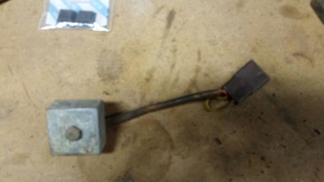

fi57 0 #1 Posted August 27, 2014 Hi : I need help with my newly purchased C145 WHEEL HORSE . The rectifier is the small block type with only two wires ,one large yellow and one small red wire, I think the mounting bolt is gnd. The unit was not wired in to the harness. Does anyone know how this is wired in? All schematics I have looked at show the 3 wire rectifiers. Thanks Share this post Link to post Share on other sites

gwest_ca-(File Mod) 11,987 #6 Posted August 29, 2014 Forgot about that. That may be the answer. Never seen one myself. Do you think it is connected to the DC+ output? Garry Share this post Link to post Share on other sites

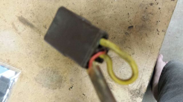

Trouty56 567 #7 Posted August 29, 2014 Yes I do.....If I remember correct 1 leg of the AC went to the sqare rectifier...then a small wire from the rectifier along with the other AC leg connected to the DC output to the switch.....but I changed it all to the other/normal system.... Share this post Link to post Share on other sites
Trouty56 567 #8 Posted August 29, 2014 (edited) Ok....here are a few pictures..... You can see the small orange wire from the rect goes to the center DC leg with the one AC leg..... Hope this helps... Excuse the deformed foot in that one pic...I had an industrial accident years ago and lost a few toes....never take on a forklift!!!! Edited August 29, 2014 by Trouty56 Share this post Link to post Share on other sites
fi57 0 #9 Posted August 29, 2014 Thanks guys for taking the time this may help. I have owned many wheel horses & this is the 2nd one I have seen . Someone had cut the wiring before I got it - Thanks again -NICK Share this post Link to post Share on other sites
