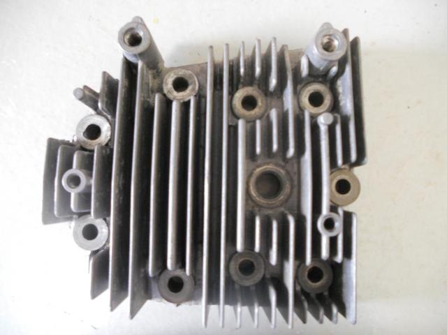

Racinbob 12,234 #3 Posted August 27, 2014 I was thinking I would be a bit hesitant to try then I remembered that I have a head off a 10hp Tecumseh that I don't care about. I'll take before pictures shortly and post them. Then I'll etank it and see what happens. Curiosity always gets the best of me. Share this post Link to post Share on other sites

Racinbob 12,234 #6 Posted August 27, 2014 You're absolutely right Jason and Bob. It shouldn't work because of no rust. Electrolysis shouldn't remove paint from non-rusted metal either but it does in some cases. I've done it for years. Researching the subject I've read that even the color of the paint makes a difference with red being one that is easier (lucky for us). I don't have a clue as to why but I'd guess it might be due to the pigments in the paint and possibility impurities in the metal. I've also read about the stainless issues and it wouldn't surprise me if aluminum does the same. I've got the head cooking right now. It's likely a dumb experiment but probably not my dumbest. Share this post Link to post Share on other sites
Racinbob 12,234 #7 Posted August 27, 2014 Forgot to post the before pictures. Share this post Link to post Share on other sites

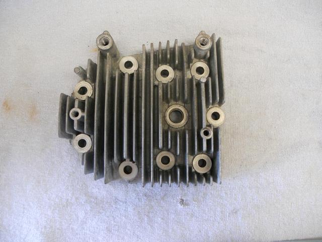

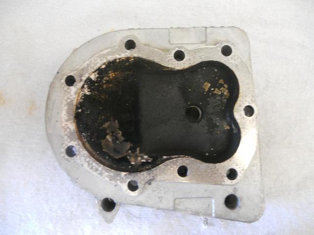

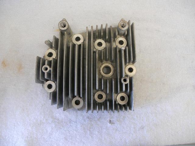

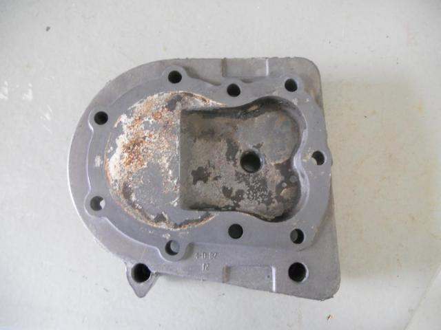

Racinbob 12,234 #17 Posted August 29, 2014 OK. The results are in. I had a delay due to things coming up but the total tank time was about 8 hours. Before I get a bunch of “I told you so’s†let me say again, I never expected it to work but I just had to see what would happen. I’ve been using electrolysis for more years than I care to admit and do have a good understanding of the process as well as, let’s just say, a wee bit of experience in the electrical industry. When I saw FarmerJim’s post it hit me that I had never tried a chunk of aluminum. Why? Cuz it won’t work. But just what would happen? I had the Tecky head that was going to end up in the trash anyways so I gave it a shot. I had brushed the carbon prior to tanking to remove the loose stuff. After removing it from the tank this morning I just washed in dish soap and lightly brushed it again. More carbon came off but that could have just been from the soaking. The remaining carbon is still attached pretty good. It doesn’t look like it harmed the head and there was no buildup on the anodes. You can see that it’s discolored some and it’s not like the usual black crud that gets washed off. I would say the bottom line is what most expected. There are much better ways to clean a head up. As far as the other issue that comes up so often, it’s not supposed to remove paint either. But it does, even on clean metal. Yes, I’m sure the quality of the paint plays a part but I’ve never failed to get at least 90% of it off. What remains seems to come off much easier. My usual procedure is to start the process on the part to be cleaned. About two hours later I remove the part and clean the loose but still clinging paint off so it doesn’t gunk up the solution so much. Then I cook it some more until I get the result I want. It’s quite possible that I’ve never tried it on a paint good enough but maybe that will be another experiment. So, FarmerJim, since you want to save your head I wouldn’t try it. I know that from firsthand experience now. I don’t think it hurt it but…………..??? If anybody else asks a question about cleaning aluminum in an e-tank you can say emphatically “NO, it won’t work cuz I once read in a forum about this idiot that tried it.†1 Share this post Link to post Share on other sites

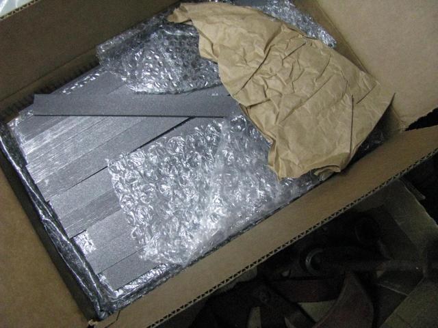

AMC RULES 37,232 #21 Posted August 30, 2014 (edited) Ever try using graphite as the anode in your e-tank Bob? Edited August 30, 2014 by AMC RULES Share this post Link to post Share on other sites
Racinbob 12,234 #22 Posted August 30, 2014 No, I haven't Craig. My latest anodes are old iron grates from a worn out smoker. They've been probably the best I've use. I'm no metallurgy dude by any means but the idea is interesting. You have some there. Are you going to try it? Share this post Link to post Share on other sites
AMC RULES 37,232 #23 Posted August 30, 2014 Supposedly, keeps the tank/ removal process much cleaner... 2 Share this post Link to post Share on other sites
FarmerJim 5 #24 Posted August 30, 2014 You gotta love ol Shop Dog Sam ! certainly not in a hurry for anything. anyone know where one could get plates like he is using?? I have top notch results with just plain old re-bar but it never hurts to try to kick it up a notch! 1 Share this post Link to post Share on other sites
AMC RULES 37,232 #25 Posted August 30, 2014 You'd be suprised... there's more graphite than you can shake a stick at listed on Ebay. If you're patient, you find exactly the size you're looking for there. Try searching "graphite scrap"...worked for me. Seller listed 8-10 pieces, but a whole box arrived for less than $20 shipped. Share this post Link to post Share on other sites
