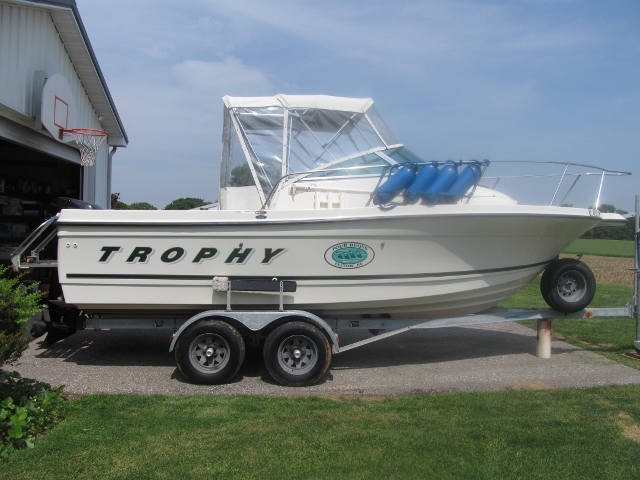

Wishin4a416 2,602 #27 Posted August 19, 2014 What kind of boat that bow pulpit belong to Ed? Share this post Link to post Share on other sites
Ed Kennell 46,581 #28 Posted August 19, 2014 That is a model 2002 Trophy WAC w/150 HP Merc. I bought it new in 2001 at Shy Beaver Marine at Raystown Lake, and actually sold it on York,Pa Craigslist a few weeks ago to a guy in Michigan. He is scheduled to pick it up this week. The new owner Has never seen the boat. My wife and I cruised , fished and camped in it for several years on Raystown lake and the Delaware Bay. Now with two sons and four grandsons that like to fish and crab the WAC is just too crowded, so I am looking for an open center or side console to gain more room. 1 Share this post Link to post Share on other sites
Wishin4a416 2,602 #29 Posted August 19, 2014 Beautiful boat Ed. I fish out of a friends just like it only 200 horse. I sold my Crestliner last year. My back just wont take Erie anymore. Share this post Link to post Share on other sites
