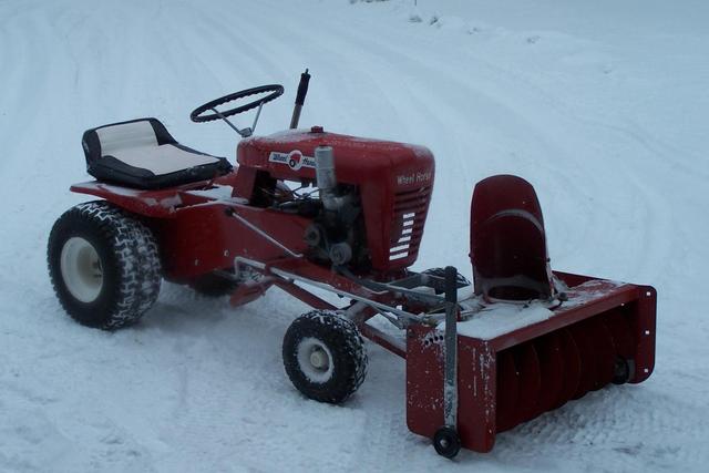

Lane Ranger 11,814 #2 Posted August 13, 2014 I think it is for a Lawn Ranger! This is a ST-324 on my 1967 Lawn Ranger Share this post Link to post Share on other sites

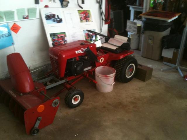

gwest_ca-(File Mod) 12,013 #3 Posted August 13, 2014 ST-324 is listed for the 1961-1965 short frame tractors except 10hp models. STR-324 fits the 1962-1965 Lawn Rangers I have never compared the 2 to see the differences. Garry Share this post Link to post Share on other sites
