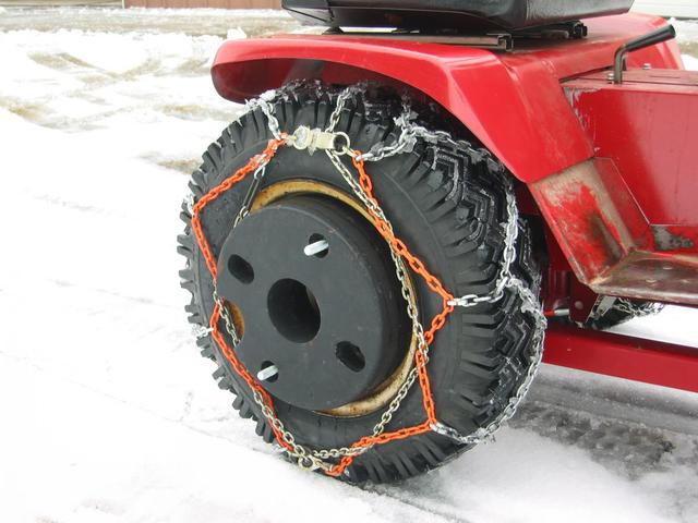

I have been impressed with this set up on an Electro12.   The narrow tires (6.00x12)  69lb weights on each side plus some more on the hitch,and the chains (the zigzag design make it a smoother ride) combined with the limited slip differential are awesome.  You can make the engine lug down before the wheels spin.
