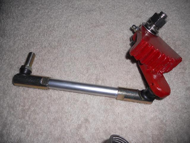

Racinbob 12,314 #7 Posted August 16, 2014 As far as your steering part you might be able to find a decent used one but those drag links wear a lot. You might be able to extend its life by peening it a bit more. It's probably easier just to make a new one using two easily available ball joints and rod. Share this post Link to post Share on other sites

dirtymax006 1 #10 Posted August 18, 2014 This is what it is. 1 Share this post Link to post Share on other sites
