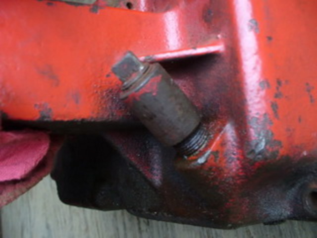

rmaynard 16,953 #8 Posted August 12, 2014 There is also a picture that TT posted one time that shows an extension on the side plug to allow level checking at that location. I know that the book says one thing, but it is a little confusing. I did the experiment with my 857 by putting in 3 pints. Then I put a measuring cup under the side plug, removed it, and 10 ounces poured out. So, either the book is wrong or I am crazy. I am sticking by "the book is wrong". Here is TT's picture showing and extension on the side. 1 Share this post Link to post Share on other sites

stevasaurus 23,631 #10 Posted August 12, 2014 Bob, if you look at the 6 speed transmission manuals, that extension is from the factory...not something that someone did. I figured we would get into this if I said something...and you asked for links in another thread a week or so ago to refute what you think is right. I put up the links, and you still do not want to believe it. That's OK. Bottom line...the manuals suggest an amount and says when the oil runs out the fill plug that is good. I do not think a little extra is going to hurt (not like a car engine being over the fill mark)...I think it is much worse not having enough oil in the trans. But remember this, the manual is talking about when you buy the tractor, and there is no oil in it...not when you drain it and you do not get all the oil out because of the rib through the center of the trans. Adding 3 pts to a trans that has oil still sitting in it (because not all of it was drained) just because the manual said it should take this...I think...is not the correct way to go. I think too much oil limits the intended splash of the gears and may not properly lubricate the gears/shafts toward the top of the trans. The correct level...is when you get oil starting to run out the fill plug. Maybe we should start a thread on this to not go on a tangent, but this was brought up here. Your 857 does not have that extension...the 10 pinion/limited slip differentials in the 6 speed transmissions do (from the factory). They may need a higher level of oil for those pinions that "float" in the differential with that spring holding them in place. That extension would accomplish that. Let me know what you think mate. Share this post Link to post Share on other sites
