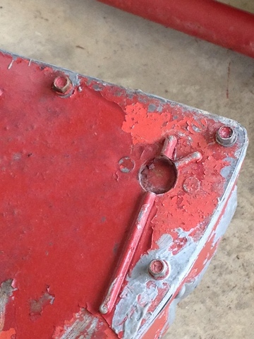

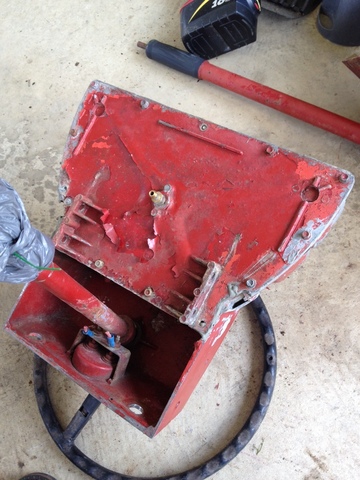

188fan 5 #1 Posted August 10, 2014 Is this what the bottom of an 854 gas tank is suppose to look like? The bottom is screwed on. Looks like a crappy design if that's a factory job. Share this post Link to post Share on other sites
AMC RULES 37,250 #2 Posted August 10, 2014 Yep, that's a factory two piece tank. Looks like that one may be leaking? Share this post Link to post Share on other sites
188fan 5 #3 Posted August 11, 2014 Yeah the guy before me tried to JB Weld it. Made a friggin mess of it. I guess if I can't find one I will have to redo this one. Share this post Link to post Share on other sites

Racinbob 12,399 #17 Posted August 11, 2014 (edited) if I'm seeing that right you have more than just a leak. It looks like a chunk of the bottom plate is missing. It's possible that it isn't in the actual tank area but outside of it. I can't tell for sure. I fixed an 854 tank with a new gasket, Permetex and several coats of tank sealer inside. I don't really like it but I'm thinking that the service bulletin thing might be your best bet but I would try to find a new bottom if that missing chunk is in the tank area. Edited August 11, 2014 by Racinbob Share this post Link to post Share on other sites

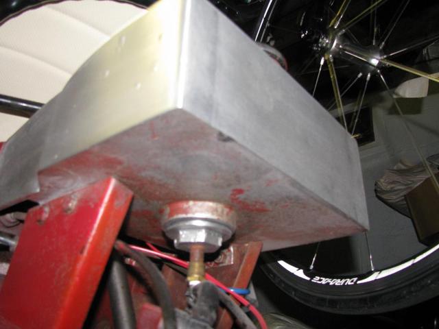

buckrancher 2,695 #18 Posted August 11, 2014 see half way down thread brian Share this post Link to post Share on other sites

Racinbob 12,399 #21 Posted August 11, 2014 Nice job on that tank Brian. From looking at that, now I'm thinking that the tank in question here isn't missing a chunk and can be saved. Share this post Link to post Share on other sites
188fan 5 #22 Posted August 21, 2014 All welded up and no leaks............ Share this post Link to post Share on other sites
