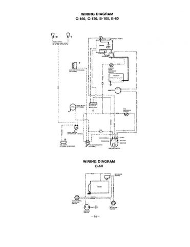

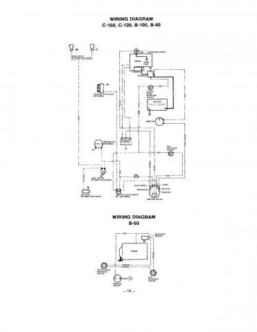

km3h 543 #15 Posted August 10, 2014 That could be your problem. The solenoid for that tractor only has one small post not two. I tried to find a way to copy the page from my pdf manual with the schematic but don't know how. What are the two post you have wired to? Share this post Link to post Share on other sites
rmaynard 16,694 #16 Posted August 10, 2014 On the solenoid with two small posts, both should be internally isolated from ground. The wire from the start switch connects to either one, and the other has to be connected to ground. Share this post Link to post Share on other sites
km3h 543 #17 Posted August 10, 2014 (edited) Click on this and it will enlarge. The ground is the mounting bracket. It must be mounted cleanly. I have used a separate wire from one of the mounting bolts and ran it directly to the battery negative post. Usually is not required but when all else fails?????? Try this. Edited August 10, 2014 by km3h Share this post Link to post Share on other sites
