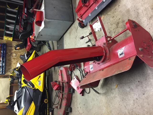

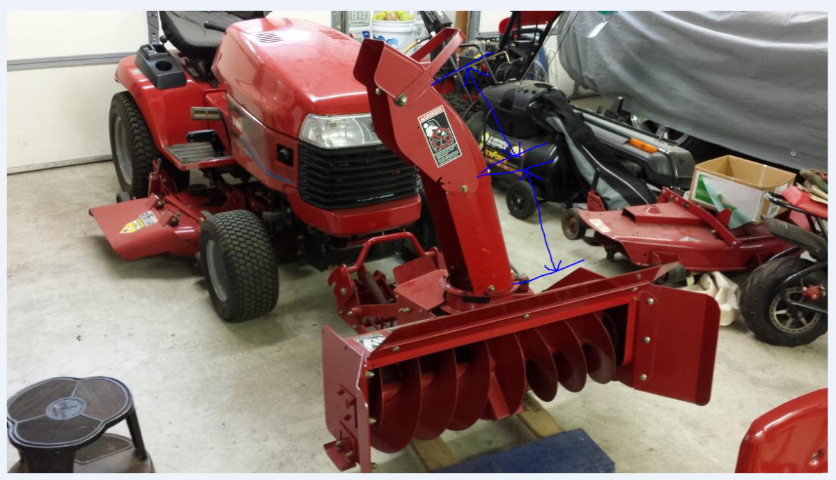

PaulC 342 #30 Posted November 10, 2014 Hey Glenn That sure is a nice blower you picked up there, looks similar to one I just got except much cleaner and hooks up to an xi not the attach a matic. Wondering if you would do me a favor when you get a minute?? Could u grab a few measurements of the chute for me? Im mainly looking from the base of the chute to the first area where it bends, then from there to the next bend. I have a chute made up and painted already but would like to reference my sizing that i came up with from photos to what a tall chute blower is actually supposed to be. I got mine cheap because it was missing the chute and a few other parts. I made up a chute myself because only two of 3 parts are available and were still going to be $175 bucks. I started a thread in the implements section trying to get some measurement but unfortunately I got no sizing responses. If you cant get to it don't worry about it. At this point i don't want to chop it at all but would like to have the actual sizes for reference. I could always alter it after i use it if it doesn't work like it should. It really wasn't hard to make either so my thought is if it works that much better then my short chute then i will convert it to a tall chute. Maybe ill come up with a kit and become a redsquare vendor Thanks Paul Share this post Link to post Share on other sites

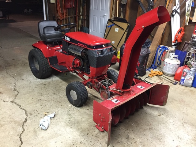

PaulC 342 #31 Posted November 10, 2014 this is what im looking for 1 Share this post Link to post Share on other sites

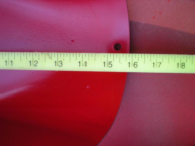

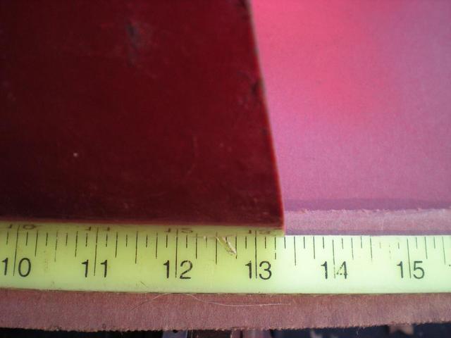

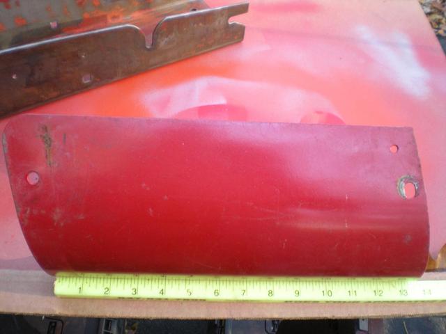

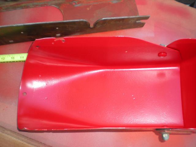

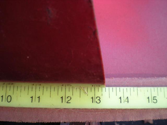

shallowwatersailor 3,222 #32 Posted November 10, 2014 Paul, I happen to have mine still apart for my 5xi. The bottom portion is 13 1/4", and the middle piece is 16". 2 Share this post Link to post Share on other sites
shallowwatersailor 3,222 #33 Posted November 10, 2014 I got the pictures to come up this time too. 2 Share this post Link to post Share on other sites

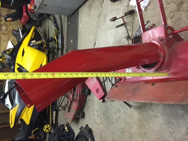

PaulC 342 #35 Posted November 10, 2014 (edited) Thanks u guys are awesome!!! It's seems my judging by photo is off a bit. If I left it as is I would have an EXTRA tall chute blower 😃. Looks like I need to cut about a foot off of the bottom section I made that 24" long and the middle section 12". I have a deflector for the top too that isn't shown. Wish I didn't have that nice paint job on it now gonna get scratched up in the saw Edited November 10, 2014 by PaulC 2 Share this post Link to post Share on other sites
RMCIII 840 #36 Posted November 10, 2014 Paul - in all honesty, it may not hurt 1 bit..... Right now, I think anyone with a single stage is seeing anywhere from a 15' t o18' height in their plume. That may even add some extra height. I know it has the muscle to get it up and out! Might be cool to see what an "extra long" chute dose for the height. Rob 2 Share this post Link to post Share on other sites
PaulC 342 #37 Posted November 11, 2014 Ya know Rob u make a very good point I should try it out before I decide to cut it and backing me up with the cool factor helps too😃. I did think that it looked a bit odd on there but looks can be deceiving. I will get it all put together and mounted and will post some more pics of it then. At that point I'll know if Ill need to sit on a phone book to see over the chute😜 2 Share this post Link to post Share on other sites

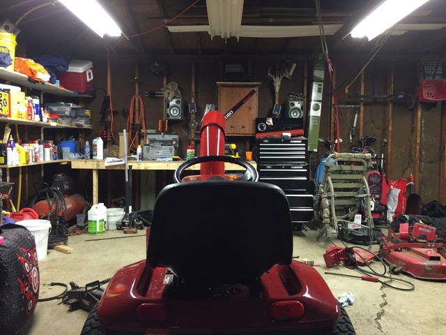

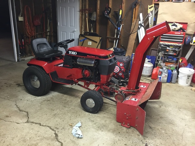

PaulC 342 #44 Posted November 12, 2014 Well gents I got the blower and EXTRA EXTRA tall chute mounted yesterday. Its rather excessive and there are things I don't like about it so I am indeed going to make a new one. I am going to keep this monster though and plan to try it out when I am bored and want to play in the snow I think I may need that phone book after all 3 Share this post Link to post Share on other sites
RMCIII 840 #45 Posted November 12, 2014 . Now that it is sitting behind the tractor, it REALLY gives a better perspective...... Glad you are going to at least try it out though. I still think it will add additional height to the plume. Since it is protected from gushing winds for about another 16" it should allow the snow to get to "NEW HEIGHTS" Rob 2 Share this post Link to post Share on other sites
