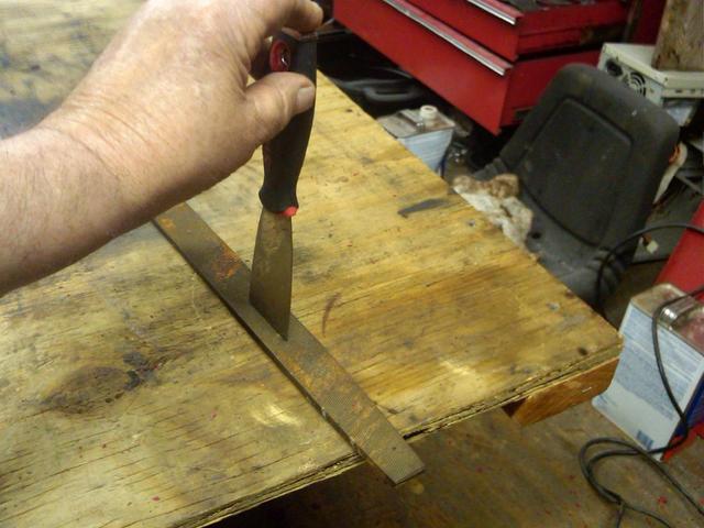

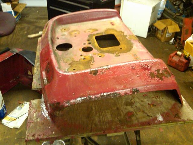

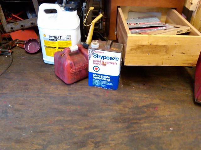

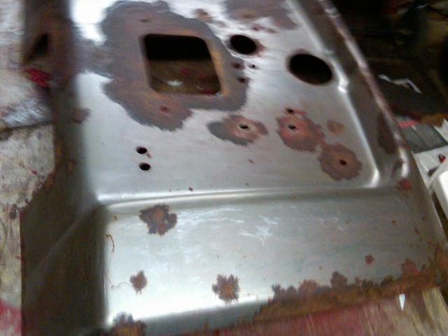

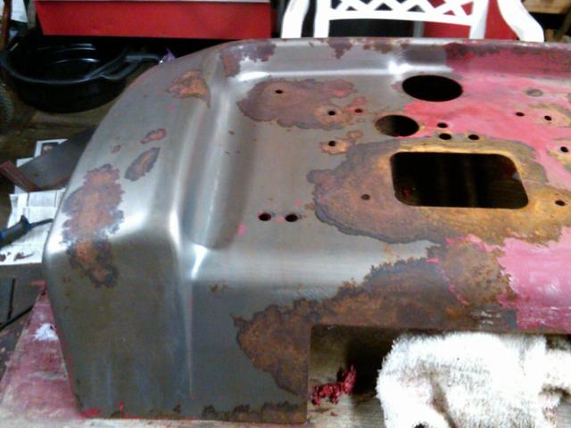

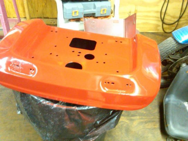

km3h 543 #24 Posted August 10, 2014 I used a paint stripper and it worked well. Don't get it on your skin. Burns like the devil. This is what I started with. Half way there. All gone Finished Painting What I used I several different sizes of putty knives as scrappers. The important thing about using them is to make the surface edge is flat. What I did was use a bastard file and stood the knife straight up and sharpen the edge frequently. You don't want a cutting edge. It should be square and flat. Like this that was the first time I tried anything like this. Like you I used a sander at first but it just did not seem like the best way to do it. I took the entire tractor down to bare metal. You paint this on with a brush and watch it bubble the paint. They you just scrape it off with the putty knife. Of course I did sand down the rust and filled it with Bondo. Nick 1 Share this post Link to post Share on other sites
546cowboy 302 #25 Posted August 10, 2014 I always use stripper myself and it takes a lot less time and elbow grease that way and if you have a pressure washer, it will take most of the paint off. After I get it down like you did I usually sand blast that rust or just spray it with rust converter and primer before I paint it. I guess you could use some kind of acid to remove the rust or maybe toilet bowl cleaner. I can hear the laughter now but have you ever tried it? As far as scrapers are concerned, I bought a set of plastic scrapers at HF a while back just for that purpose. They won't scratch the metal. 1 Share this post Link to post Share on other sites
