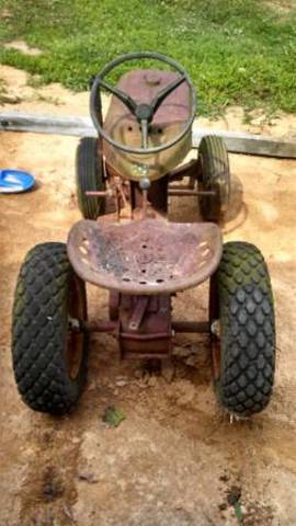

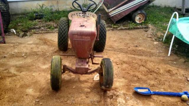

mr_speegs 1 #1 Posted August 4, 2014 (edited) So I found this chassis on CL and it is missing a few notable items, namely an engine, appropriate steering wheel, etc. The seller is not a WH guy and can't identify the exact model, but my untrained eyes of pre-1964 tractors tells me this is probably an RJ, maybe a later 551. So my query is twofold: 1. What model is this tractor? and moreover... 2. Will I be able to scrounge enough parts to restore this thing or should I hold out until I find a complete tractor? Thanks! Edited August 4, 2014 by CasualObserver changed post tag, not RJ Share this post Link to post Share on other sites
Racinbob 11,906 #2 Posted August 4, 2014 (edited) It looks like a 61 Suburban. It's a bit hard to tell in the picture but it looks like it would be a start. It depends on the price and how much of a project you are wanting to tackle. Also ask yourself what you can do such as stuff like repairing the hood, etc. Are the tires salvageable, does the transmission seem OK, etc? Edited August 4, 2014 by Racinbob Share this post Link to post Share on other sites
squonk 43,614 #3 Posted August 4, 2014 Your best bet if you buy it is to come to the big show next year with a list. Not a RJ for sure looking at the front axle. Share this post Link to post Share on other sites

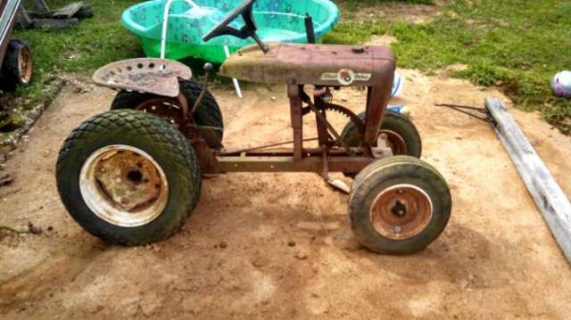

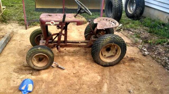

mr_speegs 1 #4 Posted August 4, 2014 (edited) Okay, good to know. Here's some other pics. I have yet to hear back from the seller as to whether or not the transmission feels seized or not (or even still shifts). He's asking $250 OBO, which seems a bit higher than I thought it should sell for. Edited August 4, 2014 by mr_speegs Share this post Link to post Share on other sites
neil 2,410 #5 Posted August 4, 2014 Definitely not an RJ , looks like a suburban, It looks like a 551 hood but it has the 3 piece transmission ????? Hmm Share this post Link to post Share on other sites
CasualObserver 3,410 #6 Posted August 4, 2014 (edited) Most likely started life as a 401. Way overpriced at $250. 61 hood and decals (dash plug and holes for push/pull throttle choke cables) 61 cast iron clutch pedal three piece trans means 401 not 551 which used two piece unidrive. Edited August 4, 2014 by CasualObserver added identifiers Share this post Link to post Share on other sites
CasualObserver 3,410 #7 Posted August 4, 2014 I should add... that this tractor looks totally restorable. Essentially it's missing is the K-91 engine, a drive belt, a drive belt guard and choke/throttle cables. All of which are easily found for a price. Even if the trans is toast, it can be rebuilt. Most parts are available... it just comes down to price to obtain them. Share this post Link to post Share on other sites
Racinbob 11,906 #8 Posted August 4, 2014 Sounds spot on to me. I also agree that it's way over priced. Share this post Link to post Share on other sites
Jake Kuhn 1,579 #9 Posted August 4, 2014 Jason is right on it being a 401. It looks like a start to a restoration, but will take you a lot of searching to find all your parts, and they can add up to quite a bit of money as its missing all the hard to find parts. It could definitely be restored, thats how a lot of mine have started...but 250 is way to much for it. I don't see it worth any more than 150. Share this post Link to post Share on other sites
Brrly1 1,146 #10 Posted August 4, 2014 Start at $50, I wouldn't go much higher than a$100. The more I think about it I don't even know if it's worth a $100 2 Share this post Link to post Share on other sites
AMC RULES 37,194 #11 Posted August 4, 2014 Easy enough to bring back to life... just depends on how bad you want to play. Agreed...$100 is your maximum bid... leave your contact info, then walk away. Share this post Link to post Share on other sites
Ken B 3,189 #12 Posted August 4, 2014 Anything can be restored... I'd wait to find something without a butchered hood and a more complete tractor.. Share this post Link to post Share on other sites
mr_speegs 1 #13 Posted August 4, 2014 Thanks, everyone. I think I'm walking away from this one. I don't think someone asking $250 can be talked down to $100 or less. This is going to be too ambitious of a restoration for me until i gain some more chops. Share this post Link to post Share on other sites

speedyleedy 205 #17 Posted August 5, 2014 So can i ask why the frame is so much longer then the hood ? 1 Share this post Link to post Share on other sites
Geno 1,929 #18 Posted August 5, 2014 Very nice observation, looks like we all missed that one. Share this post Link to post Share on other sites
857 horse 2,588 #19 Posted August 6, 2014 im guessing the frame length is ok....the steering shaft is on the wrong hole in the hood...but the hood is cut......and like most said,,,,everything can be fixed with $$$$,,,but i do like the rear tires...im giving them a cool factor of about 8. Share this post Link to post Share on other sites
cruisnblue48 856 #20 Posted August 7, 2014 (edited) Looks like the hood was cut and raised to put a larger engine in it. The hood being raised would also move backwards sliding up the steering shaft. I paid $75 for a 551 roller about three years ago... no engine or hood. Anything can be rebuilt, just depends how much time and money you have or want to put into it. They don't have to be restored to original condition when they look that bad. I am tearing mine down now to make it a hot rod tractor. That condition with a cut hood, not worth more than $100 as it sits. Edited August 7, 2014 by cruisnblue48 Share this post Link to post Share on other sites
