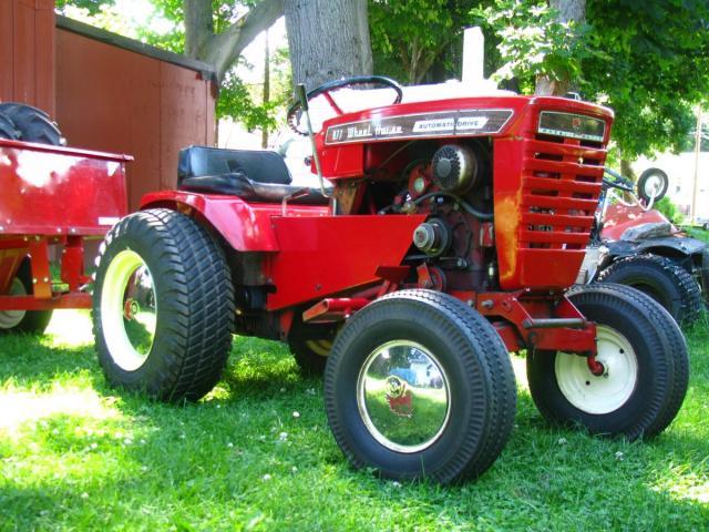

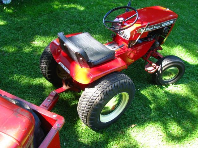

AMC RULES 37,251 #6 Posted July 31, 2014 (edited) Great little 's they are... nice score there. Couple picts here to inspire you. Edited July 31, 2014 by AMC RULES 1 Share this post Link to post Share on other sites

ljones 9 #16 Posted August 2, 2014 (edited) What's the pedal that goes to the trans on the flywheel side of the one AMC RULES has? Edited August 2, 2014 by ljones Share this post Link to post Share on other sites
AMC RULES 37,251 #17 Posted August 2, 2014 (edited) Clutch pedal. Returns the trans to its neutral position... which in turn, locks it up like a brake. http://www.wheelhorseforum.com/files/download/1113-tractor-1967-877-om-ipl-wiringpdf/ You can't roll this tractor in the neutral position, without opening the tow valve first. Edited August 2, 2014 by AMC RULES Share this post Link to post Share on other sites
ljones 9 #18 Posted August 2, 2014 Clutch pedal. Returns the trans to its neutral position... which in turn, locks it up like a brake. http://www.wheelhorseforum.com/files/download/1113-tractor-1967-877-om-ipl-wiringpdf/ You can't roll this tractor in the neutral position, without opening the tow valve first. It looks like that is missing on mine. Share this post Link to post Share on other sites
