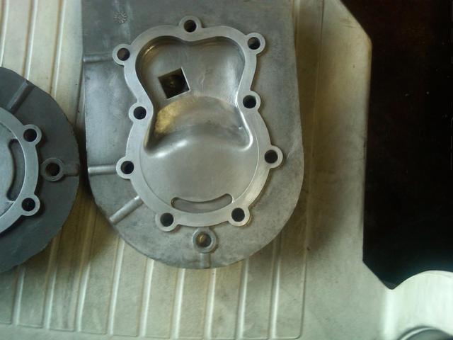

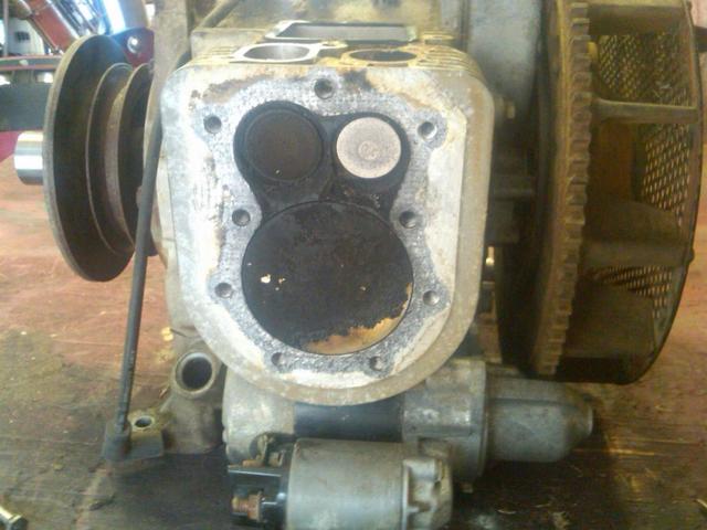

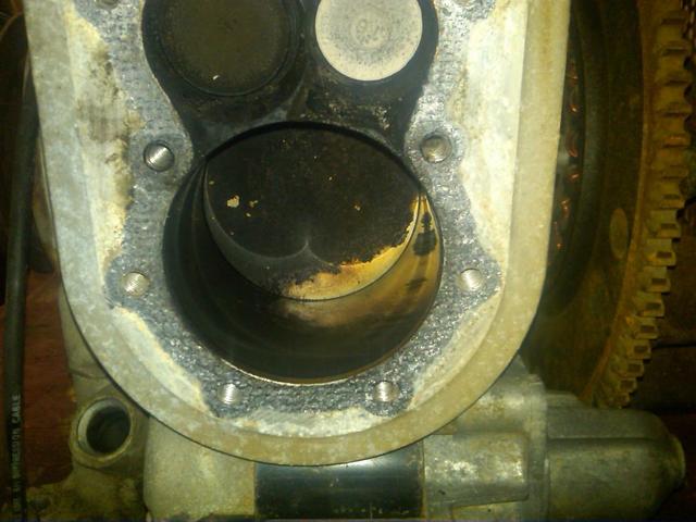

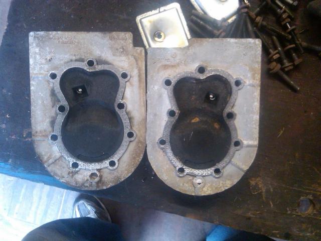

km3h 543 #1 Posted July 29, 2014 (edited) Since I had to move the engine forward to replace the fuse block on one of my 416H's, and the engine now has 532 hours on it, I decided to pull the engine and remove the carbon from the heads and valves. I am very glad I did. I have torn down a lot of engines but I don't believe I have ever seen one with this much carbon on it. It looks like I will spend the winter months de-carbonizing the other Onan engine and my two KT17's. Engine runs perfectly,idles smoothly and fires up instantly, so the carbon was not causing any problems. There were some places that the buildup was sort of knotted up and I don't think it would have helped any if these pieces had broken loose and gotten into the bore which is still like glass. Called Boomer and ordered the gaskets and will do some other work while waiting for them to arrive. By the way, what should I use to remove the carbon. I tried carburetor cleaner and brake cleaner and neither works well. There must be something that will dissolve this stuff. Edited July 29, 2014 by km3h Share this post Link to post Share on other sites

km3h 543 #4 Posted July 30, 2014 I was very surprised when I pulled the heads and saw all that carbon. As I said before the engine runs perfectly, with no obscene noises. Almost as if it was run on leaded gas. I have been doing some research on the subject and a lot of folks seem to use Easy Off oven cleaner. I am not sure if that stuff will hurt aluminum. Tomorrow I will pull the valves out and give them a good cleaning. I checked the valve clearance and even after over 500 hours they were right on specs, .005 for the intake and .013 for the exhaust. Share this post Link to post Share on other sites

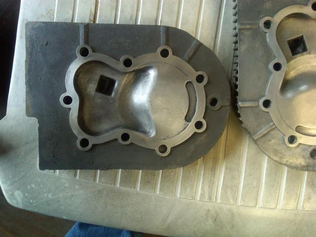

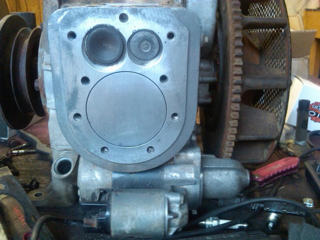

km3h 543 #11 Posted July 31, 2014 (edited) Worked on de-carbon the heads and pistons today. Cam out nice. Still have a little work to do on the valves. I may take them out to make sure everything is absolutely clean. Lot of scotchbrite and brake cleaner along with some thinner. Rub, Rub, and Rub. Edited July 31, 2014 by km3h Share this post Link to post Share on other sites

Martin 2,133 #13 Posted August 1, 2014 Nick, looks like you put some time in there....... sore fingers tonight? Share this post Link to post Share on other sites
km3h 543 #14 Posted August 1, 2014 Yes they are a little sore but it has been worth it. Not as nice as the job you did but good enough for government work. I will do a bit more tomorrow. I still have to install that fuse holder too. 1 Share this post Link to post Share on other sites
boomers_influence 106 #15 Posted August 1, 2014 nick BEAUTIFUL job. thank you boomer Share this post Link to post Share on other sites
km3h 543 #16 Posted August 1, 2014 nick BEAUTIFUL job. thank you boomer Coming from an old pro like you, I really appreciate that. Share this post Link to post Share on other sites
