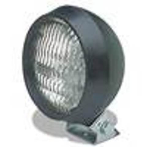

Butch 194 #1 Posted July 27, 2014 I've been waiting for them to show up on Ebay. Part number 102881. No luck. I can find them at the typical parts stores. $36 each! Wow! Decided to do some searching and cross referencing and found these http://www.replacementlightbulbs.com/lamp41111.html. $4.85 each and I THINK they're halogens based on other places that sell them. Shipping wasn't bad for 2 day priority. So I bought 6. I got 6 for the price of one! I hope we can post links here. I don't remember the rules. 4 Share this post Link to post Share on other sites

"D"- Man 827 #3 Posted July 27, 2014 Butch that is the exact part listed in the manual, thanks for sharing, Mark. Share this post Link to post Share on other sites
JERSEYHAWG / Glenn 4,499 #4 Posted July 27, 2014 butch, nice. Do you know if they are halogen will they work? no messing with voltage wires etc? I dont know. Glenn,,,,,,your neighbor in central jersey shore area,,,lol Share this post Link to post Share on other sites
Butch 194 #5 Posted July 27, 2014 It was $12.60 to ship 6 bulbs USPS 2 day priority mail. They are 35 watt. They may have the 55 watt also. I was just looking for the part number from my C-85. Share this post Link to post Share on other sites
Butch 194 #6 Posted July 27, 2014 butch, nice. Do you know if they are halogen will they work? no messing with voltage wires etc? I dont know. Glenn,,,,,,your neighbor in central jersey shore area,,,lol Glen based on the photo they look like the ones in my tractor now. It has those spade type connectors which my tractor uses. Share this post Link to post Share on other sites

squonk 44,897 #10 Posted July 27, 2014 4411 is a common Par 36 tractor 12 V lamp. You can get them at TSC , NAPA. They usually sell them as a tractor work light with the rubber mounting. The dash -1 on the end designates whether it's a spade or screw wire connection. Either one will work. If you burn out a bulb you can get one locally. Just take the bulb out of the rubber housing. 1 Share this post Link to post Share on other sites

Butch 194 #14 Posted August 2, 2014 I got the headlights. Nowhere on the light or packaging does it say Halogen. But I have found Halogen headlights with the same part number and cheap price. So I don't know what I have but I have 6 of them!! Share this post Link to post Share on other sites
Geno 1,930 #15 Posted August 2, 2014 I looked at your link above to be sure and yes, they are par 36 halogens. Share this post Link to post Share on other sites
