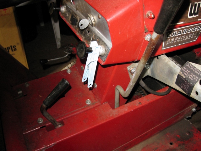

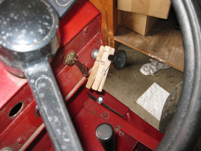

pfrederi 20,018 #10 Posted July 28, 2014 (edited) Two clothes pins work on my Electro 12. One clothes pin for fast idle two for mowing. A whole lot cheaper than a new cable. Cheap cruise control (I use the same setup on My M37's hand throttle to keep her at fast idle for warming up) Edited July 28, 2014 by pfrederi 1 Share this post Link to post Share on other sites

pfrederi 20,018 #15 Posted July 29, 2014 As long as your socks or other things aren't blowing in the wind I'd guess you'd be ok Rick Red Neck Cruise control one at fast idle one at mowing speed.... 2 Share this post Link to post Share on other sites

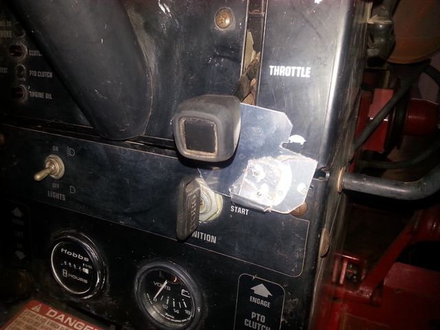

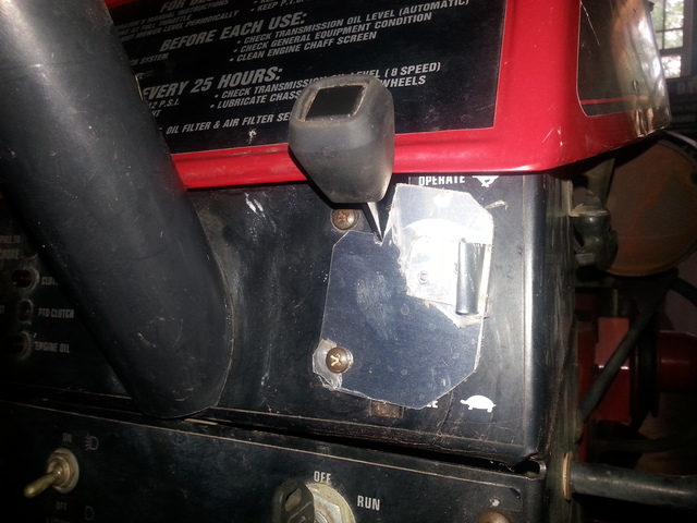

Mappingpilot 0 #17 Posted July 30, 2015 I have the same problem with a recently acquired 416-8. I made a retainer out of some scrap aluminum on my scroll saw (see attached pics). Not pretty, but it works. Share this post Link to post Share on other sites

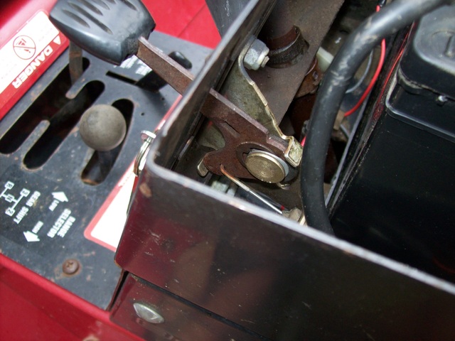

Kelsey 91 #20 Posted July 31, 2015 (edited) The past week or so, I was working on my son's 310-8 and he showed me that histhe WH throttle's handle would vibrate down while the engine was running. It looked likethe flat spring was in place. I used a E-clip and tapped in between the flat spring and thethrottle handle with a small flathead screw driver and hammer. The throttle stays in positionwithout slipping downward. Edited July 31, 2015 by Kelsey Share this post Link to post Share on other sites
bmsgaffer 2,069 #21 Posted July 31, 2015 Retainer, clothespins? Maybe a little unsafe too?? Come on guys. My 857 wouldn't hold either, so I replaced it with a regular lever style for under $10.00. I like it a lot better than the old push pull set up. That's OK for the choke, but not the throttle. I disagree. The throttle has no bearing on safety if your key switch and clutch work correctly... I cant see any situation where the throttle would be a safety issue. The past week or so, I was working on my son's 310-8 and he showed me that histhe WH throttle's handle would vibrate down while the engine was running. It looked likethe flat spring was in place. I used a E-clip and tapped in between the flat spring and thethrottle handle with a small flathead screw driver and hammer. The throttle stays in positionwithout slipping downward. That's a pretty slick idea, looks a heck of a lot easier than drilling out and replacing with a bolt and lock nut. Does it slip at all? Like, do you foresee it falling out at some point? Share this post Link to post Share on other sites

Kelsey 91 #23 Posted July 31, 2015 Retainer, clothespins? Maybe a little unsafe too?? Come on guys. My 857 wouldn't hold either, so I replaced it with a regular lever style for under $10.00. I like it a lot better than the old push pull set up. That's OK for the choke, but not the throttle. I disagree. The throttle has no bearing on safety if your key switch and clutch work correctly... I cant see any situation where the throttle would be a safety issue. The past week or so, I was working on my son's 310-8 and he showed me that histhe WH throttle's handle would vibrate down while the engine was running. It looked likethe flat spring was in place. I used a E-clip and tapped in between the flat spring and thethrottle handle with a small flathead screw driver and hammer. The throttle stays in positionwithout slipping downward. That's a pretty slick idea, looks a heck of a lot easier than drilling out and replacing with a bolt and lock nut. Does it slip at all? Like, do you foresee it falling out at some point? The E-clip fits fairly tight against the flat spring and the throttle handle doesn't driftdownward as it did without the clip. I don't think the clip will fall out but time will tell.The E-clip came from the WH 310 hood's pivot shaft that was replaced with bushings and shoulderbolts with nylock nuts. The clip just happened to be handy at the time. 1 Share this post Link to post Share on other sites
