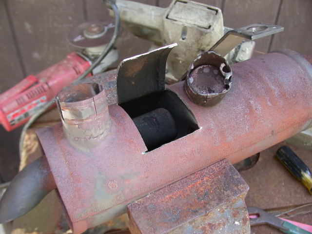

Got a welder?  I had to cut my 414-8's muffler open to remove a restriction, and just welded it shut. Cut back to thicker metal and weld shut.
This was a weird problem to solve.
The inlet tube on the muffler, sticks inside the muffler an inch or so. The end of it is welded shut. It has a ring of holes drilled around the tube for the exhaust to enter the muffler.
This end rotted off, and the end piece was loose in the muffler.
I would be mowing the grass, and loose 85% power. If I shut it off and restarted it would run ok for a while, then loose power again.
When the tube end happened to move near the outlet, exhaust pressure would push it against the outlet and restrict exhaust. Turning engine off, and it would fall down, and all was well, untill it happened again.
I diagnosed it by putting my hand by the exhaust, when it happened, and there wasn't much pressure. Took muffler off and shook it and heard the piece rattle inside.

over60pirate that is exactly what happened to mine!! I thought it was everything else but the muffler I had the carb off 4 different times :laughing-rofl: I even swapped the carbs between my 2 tractors. it wasn't until talking about it with my younger brother that he mentioned it sounded like a problem he had with a car that turned out to be clogged cats. so we quickly swapped mufflers and bam problem solved. I actually cut both end off of mine at the indent, made a new inlet tube, reassembled and welded shut. Those mufflers are a pretty cool design.
I checked with Kelly and he did not have any of those mufflers in stock. They are pricey even used so fixing is the best option.
