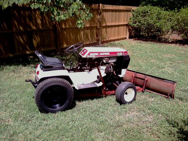

and here's a pic of the semi restored GT 1600, my plan is to also modify the foot rest as well as the current seat pan to flow with the lines of whichever fender I use.
Has anyone done this?? Pictures please too, thanks!!

Not yet :(  I finked out on the round fenders after seeing where someone (on here) used a set of squared off fenders from another model Wheel Horse model, looked pretty sweet. So I set about to finding a set of fenders that looked like they would fit the bill and what I found were Case 446 fenders that I will modify to fit, as well as modify the foot rests. I think they will give it the "big tractor" look without conflicting the lines. I also have a 520 swept axle set up that I am going to eventually install. All that said, I work away from home and won't be home for another week or so...but then, it's game on.

I did a "dry run" with my fender idea. I think it turned out ~ok. I think/know they need to be positioned lower, but I am also going to run taller tires...probably in the 28" range. They actually worked out pretty good this way, I removed the seat pan, bent 2 of the tabs in and the remaining one used the original seat mount bolt. Once I get the bigger tires on I will add more, so maybe consider this a teaser(??)
Thoughts/opinions welcome. Ps, this is my daughter's tractor, I modified the clutch pedal to be used with the deck lift rod.

Thanks. I know it needs some more work to make it look just right, right now it does look interesting . I was thinking of going with the Kenda K299 Klaw, very aggressive, almost like a tractor tire, but it has side tread and some horizontal tread as well. I have them on my 4 wheeler and the pull great.
Daughter loves it, she pulled me and my wife around in a wagon most of the day.
