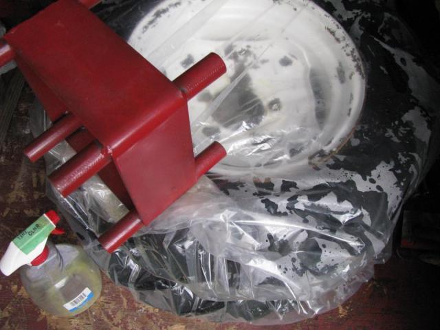

JamesC-120 204 #1 Posted July 17, 2014 (edited) I put dual wheels on my c-120 and I used carriage bolts and put them through the rims, but the rims started to twist the bolts. My question is. does these rubber spacers work? Thanks Edited July 17, 2014 by JamesC-120 Share this post Link to post Share on other sites
AMC RULES 37,237 #2 Posted July 17, 2014 (edited) I think you'll need to use a wheel spacer between the wheels... that the carriage bolts go through to prevent that twisting from happening. Edited July 17, 2014 by AMC RULES 1 Share this post Link to post Share on other sites
JamesC-120 204 #3 Posted July 18, 2014 Sounds good, I will get some of those made, I found the diagram for them. Thanks James 1 Share this post Link to post Share on other sites
