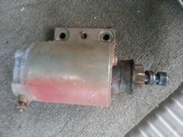

humnbass 0 #3 Posted July 17, 2014 Removed the starter because I couldn't stand that loud grinding noise when it was getting stuck on the flywheel while trying to disengage and found that it has no return spring at all. Is this a part that I can get by itself or do I have to replace the starter? thank you. Share this post Link to post Share on other sites
oldredrider 2,553 #4 Posted July 17, 2014 NAPA carries some small engine stuff. See if they can find you one. Most any lawn mower shop should be able to get that spring for you. Share this post Link to post Share on other sites
humnbass 0 #5 Posted July 17, 2014 Got the starter fixed. I went to the lawn mower parts and repair shop and got the "that part is discontinued" spill. So I went to a place that rebuilds car and truck starters and alternators. The guy grabbed an old starter off the shelf, snatched the spring off and placed it on my starter for no charge. Hopefully I'll have some additional progress to share with you guys tomorrow and Thanks for all of your help. This forum is the best. Share this post Link to post Share on other sites
