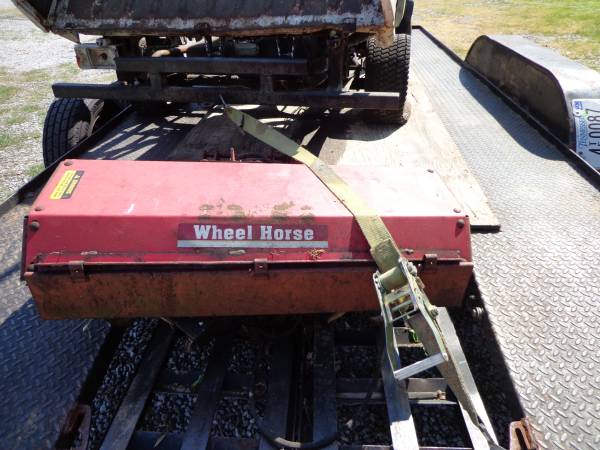

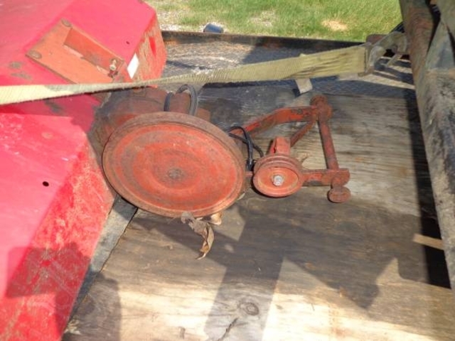

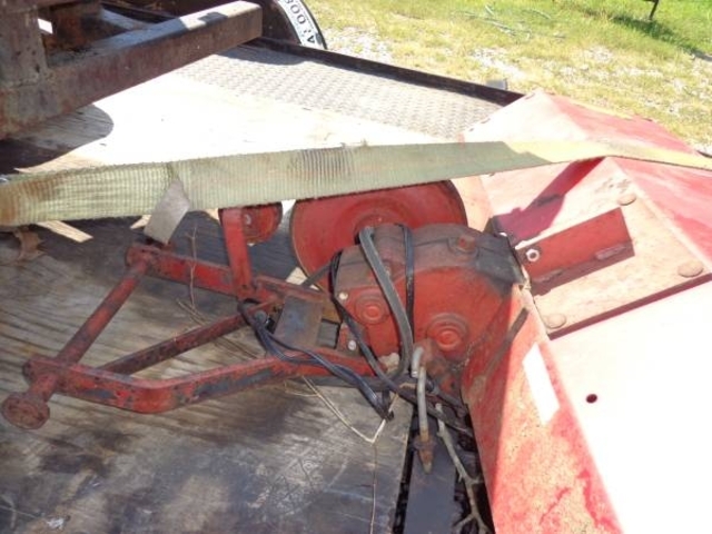

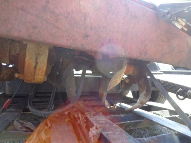

silversolder429 0 #11 Posted July 24, 2014 okay guys found this tiller for 100.00 , 3 hour drive , does this look like it will attach to my C 175 ? he says he has the mid mount pully too , besides that what else is missing ? and what hitch do i need ? thank you Share this post Link to post Share on other sites
silversolder429 0 #12 Posted July 24, 2014 sorry guys this tiller is available for 100/00 about 3 hours from me it does have the mid mount pully , but what else if anything is missing ? and what hitch do i need for this ? im hoping someone can tell me if this will attach to my C 175 by the pics as the guy says he cant see the model # , thanks in advance Share this post Link to post Share on other sites
Fun Engineer 862 #13 Posted July 24, 2014 I'm going to guess that living in Georgia you don't have a snowplow so you're probably going to need the rear axle snowplowRototiller bracket. I can't help identify the particular Rototiller you're looking at, sorry. Sent from my tractor seat. Share this post Link to post Share on other sites
gwest_ca-(File Mod) 11,912 #14 Posted July 24, 2014 Here is what we have for the 1980-82 tiller for the C-175 1983-85 tiller for C-175 Garry Share this post Link to post Share on other sites
tbarnhart 240 #15 Posted July 25, 2014 That tiller should fit your tractor, but you will need the rear axle bracket for a tiller/snowplow to attach it to the tractor. You will also need the lift cable setup and the rockshaft parts that go under the seat. I don't know if your tractor has any of those parts installed, but the quoted price is good for a tiller and mid idler. I would have some of the parts to hook that up, but I'm not sure I would have everything. It would depend on what is on your tractor. I live 3 hrs. south of you so its too far away to take a look. I'm leaving the country for a few weeks, but if you still need some help in a couple weeks, send me a message. Just remembered that the lift cable setup would be different depending on which transmission you have in that C-175 (8-speed, Sundstrand auto, or Eaton auto) so that info would make a difference as well. Share this post Link to post Share on other sites
silversolder429 0 #16 Posted July 25, 2014 @ tbarnhart , thank you I did go get the tiller , and I will take you up on the offer for you help . I will PM you . Oh yeah my tractor is an 8 speed , also thank you to everyone for your help , knowledge , and responses . I must have this ready by spring to till , so when I bring home another one , it will go over smooth with the wife , I think I found a new hobby , thanks again Share this post Link to post Share on other sites
