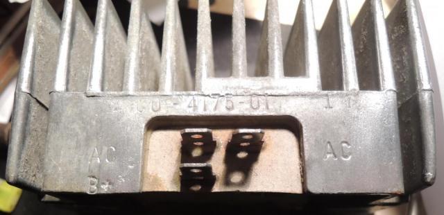

WH nut 553 #7 Posted July 14, 2014 The wires hook to the regulator See wire diagram Share this post Link to post Share on other sites
rmaynard 16,211 #8 Posted July 14, 2014 The regulator/rectifier has two tabs marked AC. That's where they attach. Share this post Link to post Share on other sites
Metal hauler 7 #9 Posted July 14, 2014 Thanks, does it matter though which ones there hooked too, they are both white coming off the stator. Share this post Link to post Share on other sites
rmaynard 16,211 #10 Posted July 14, 2014 No, it is AC not DC. Either wire to either lug. Share this post Link to post Share on other sites
