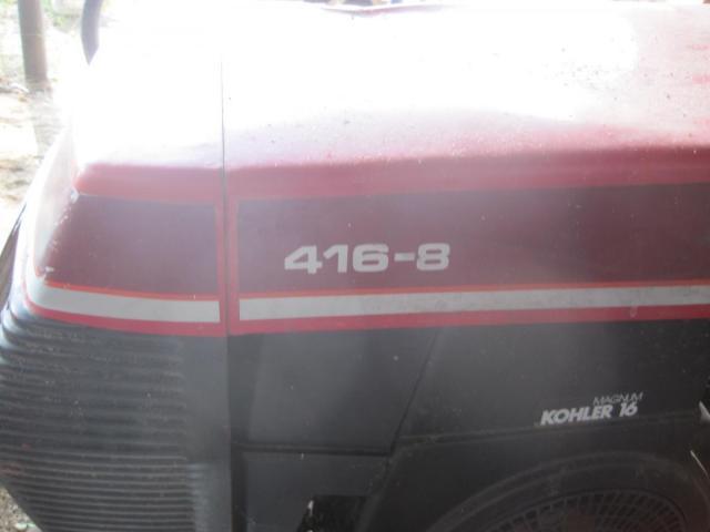

Nathanielperz 150 #10 Posted July 14, 2014 The tractor is a 416-8 Share this post Link to post Share on other sites
boovuc 1,090 #11 Posted July 15, 2014 The 416-8 Speed came in three flavors over the years. A Kohler 16 horse single cylinder K341, a single cyl M16 Kohler Magnum and the later Onan 16 horsepower twin. Please look at the engine and tell us if it's a single cyl or a twin and that will remove any doubt we have about any advice we can give Nate. If he is sure it's a Kohler, we need to know if it's the older K series with a breaker ignition or the Magnum series with a breakerless, (no points or condenser), ignition. It could be a couple things causing it but very different things between those three motors. Share this post Link to post Share on other sites

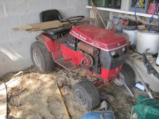

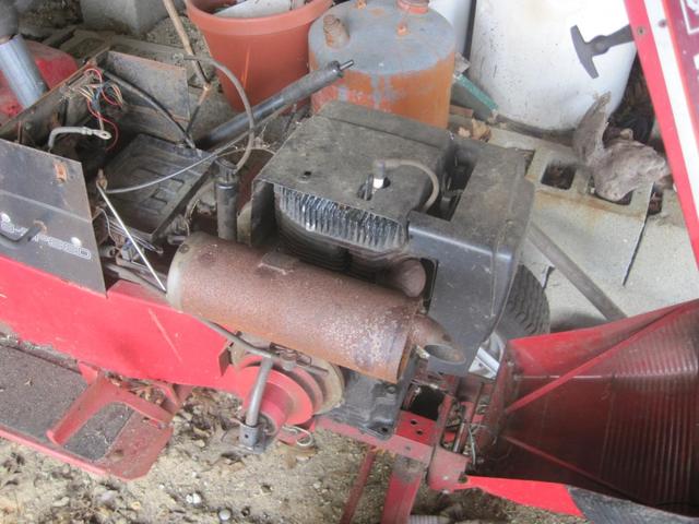

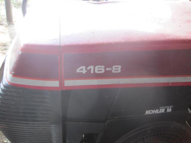

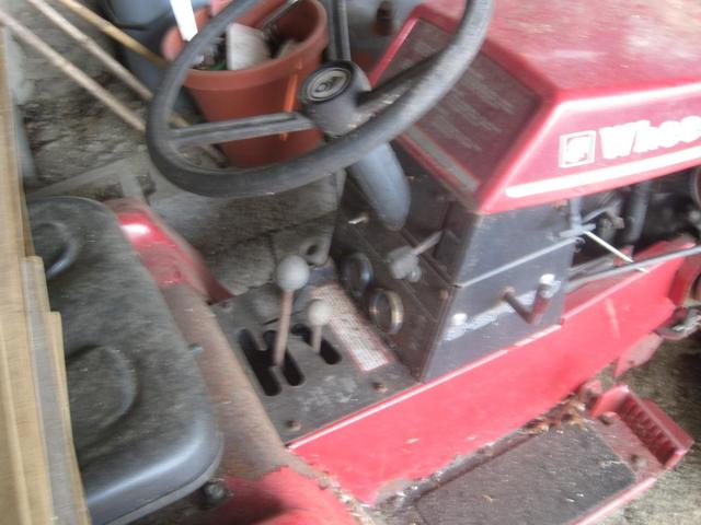

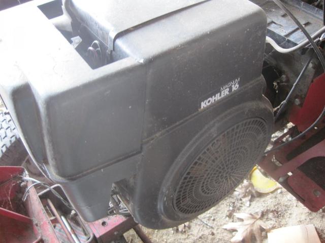

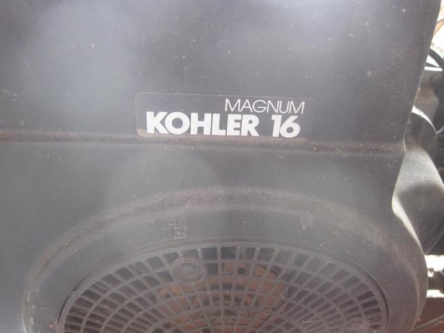

Nathanielperz 150 #17 Posted July 18, 2014 Here are the pics.... 1 Share this post Link to post Share on other sites
Nathanielperz 150 #18 Posted July 19, 2014 What do you think the problem is? Any ideas are greatly appreciated! Thanks, Nate Share this post Link to post Share on other sites
chazm 413 #19 Posted July 20, 2014 Well Nate,from your pics ,I can tell ya what the problem is.. You need to put a battery in it .... You said you replaced the fuel filter... did you replace the gas line ??? From the looks of your its been sitting awhile & old gas line deteriorates after time. Also clean the tank to get any junk out of it as well ... This would be a starting point buddy.... 1 Share this post Link to post Share on other sites
