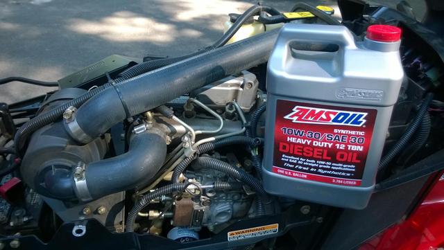

shallowwatersailor 3,221 #36 Posted July 13, 2014 Not advertising but this and a Napa Platinum filter is what I am using in the new-to-me 523Dxi.The OE filter is a little bitty thing less than three inches tall. I was able to cross-reference to the Napa (Wix) filter which is a 1/2" taller. It allows for a little more oil to circulate. Share this post Link to post Share on other sites
