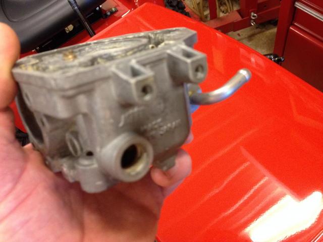

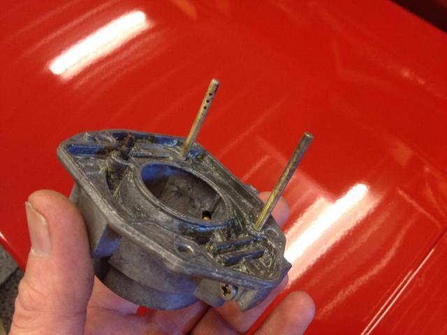

Martin 2,133 #8 Posted July 13, 2014 i have done the Onan carbs both on and off the engines. On the engine gets most of the problems solved most of the time. Even if you are only having problems at high rpm, the idle circuits feed the carb throughout the rpm, so its best to look at every area of the carb. most of the junk that i have removed with tip cleaners, carb cleaner, sea foam or other cleaners wouldn't remove. so you need to check all the small holes and inside the brass tubes that they are clear. there is a tube or tubes (depending on whether its an emissions carb) that is pressed into the top of the carb, you will see it when you pull the top off, the little holes along the sides of the tube get blocked, the end is supposed to be blocked off on one of them (the older non emissions carbs with one tube is supposed to be blocked on the end) so don't worry about that. this is the top of an emissions carb..... also the idle tube that screws in to the main body of the carb needs to be removed and cleaned. this tube has holes along the sides and at the end, you should be able to see right through it from end to end and sideways through the holes...... heres a pic of the idle tube that needs to be unscrewed from the main body, this one is just sitting in the hole with the threads exposed.... make sure the fuel bowl is completely clean, anything there is going to be sucked up by the main jet. you will see that at the bottom of the bowl to the front of the carb as it sits on the engine. this can be removed by removing the plug in the side of the carb and then using a tight fitting flat blade the jet can be unscrewed. i have found junk behind the main jet in those passages too. they can be flushed by squirting carb cleaner down those holes in the top (see approx 3/16 size holes next to idle tube in above pic) and through the holes where the idle and main are. main jet plug location, main jet is back in behind this hole on the inside of the fuel bowl.... watch your eyes and skin, the carb cleaner can shoot back at you on occasions.... heres my first dealings with a p216 with the nikki carb, a 95 pre emissions one, there is a better pic of the idle tube removed and the holes to clean..... 1 Share this post Link to post Share on other sites

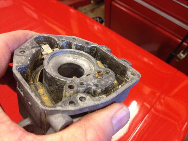

fourwheels0 191 #14 Posted July 15, 2014 ok it's back to surging and won't idle. it ran good before i put it all back together or i thought it did (gas tank,seat pan,seat ect.) the gas gauge doesn't work and i'm thinking it may be electrical. i'm gonna unplug the gas gauge and see if that changes anything. i've got fresh fuel with fresh seafoam in it. Share this post Link to post Share on other sites
Martin 2,133 #15 Posted July 15, 2014 (edited) 1 1/4 turns out, are you sure you got all the little holes clear? These are not your grandmas old kohler carb you know........ they will take you on a journey to higher levels of carb cleaning...... Sent from my iPhone using Tapatalk Edited July 15, 2014 by Martin 2 Share this post Link to post Share on other sites
Martin 2,133 #16 Posted July 15, 2014 (edited) I see your problem from your pic......... Above the mixture screw there is supposed to be a small plug covering that hole, (look inside you will see 2 or 3 little holes through to the venturi) yours is missing, probably blew out while cleaning....... This will most definitely cause the symptoms you have now...... Sent from my iPhone using Tapatalk Edited July 15, 2014 by Martin 2 Share this post Link to post Share on other sites
fourwheels0 191 #17 Posted July 15, 2014 martin i was wondering about that and yes i do see little holes in there. what should i use to plug it back up?. Share this post Link to post Share on other sites
fourwheels0 191 #18 Posted July 15, 2014 MARTIN you are the man!!!!!!!!!!!. sure enough i went and put my finger over it and it fired right up and idled perfect and revs up wide open with NO surging. i can't thank you enough!!!!!!!!!!!!!!. 1 Share this post Link to post Share on other sites
