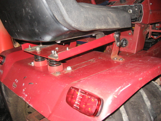

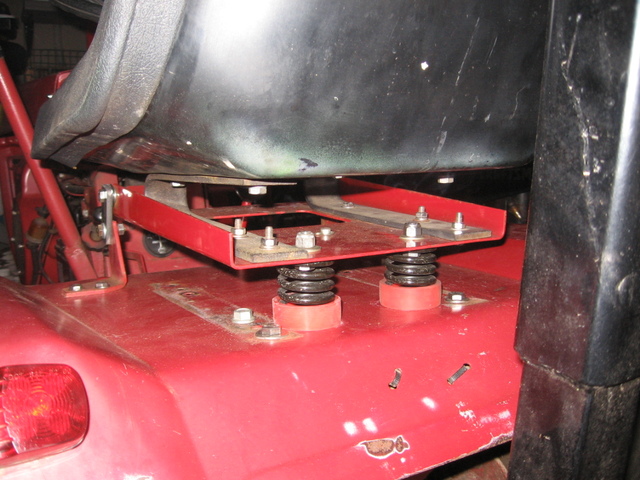

Crow Horse 8 #1 Posted July 6, 2014 I finally got all the parts I wanted to incorporate for this upgrade. I'm not done with it but it's close and is completely functional. I used a flip up seat from a 211-4, replaced the Wheel Horse springs with a pair from a Craftsman tractor (higher spring rate), a pair of silicone caps for spring seats, and a pair of home made extensions to lift the front of the seat bracket higher. It does sit quite a bit higher than with the stock springs but the combination has really tamed the ride. I also added some memory foam under the seat cover. I might add a strut to keep the seat in the up position, fab some better front lift brackets and alter some other minor items but it's good to go and I like it....... Yes, I know I do need to paint the old girl, but she's a worker.... 2 Share this post Link to post Share on other sites

glenn27 71 #3 Posted July 6, 2014 That is a good workable seat, now! I like the results! Might do something like that to my C-120A when I put the new rear pan on it! glenn Share this post Link to post Share on other sites

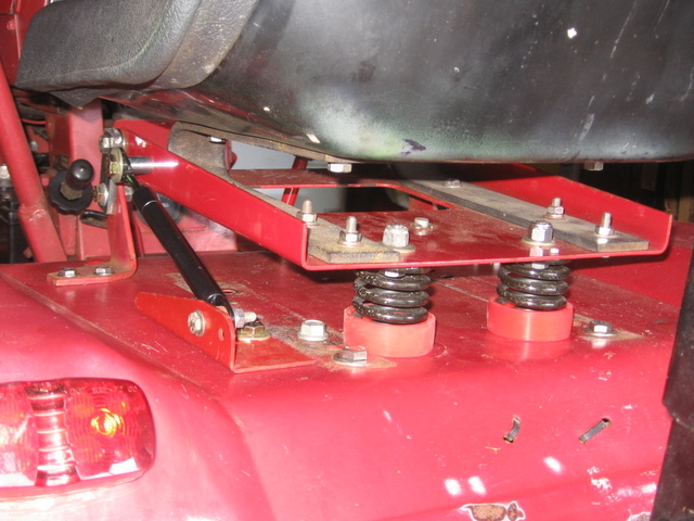

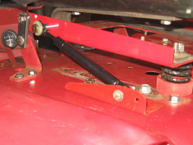

Crow Horse 8 #4 Posted July 12, 2014 With the lift strut (Strong Arm F4673) installed. I'll probably wip up some backing plates to eliminate any flex of the pan. It works really well....... 1 Share this post Link to post Share on other sites
