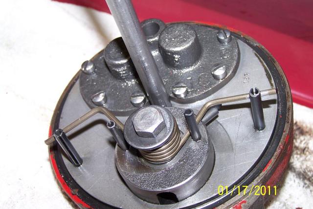

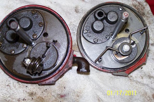

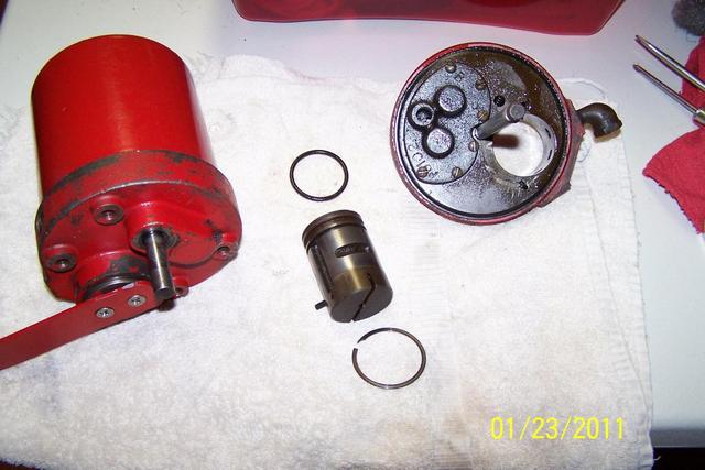

Lane Ranger 12,094 #4 Posted July 3, 2014 Juss10: O ring inside pump could be worn down. If lift cylinder is ok the big O ring in the pump cylinder may be the culprit. Akso a spring breaking can be a problem as the piston will turn freely but not to the points you need to move the fluid in the pump. Share this post Link to post Share on other sites

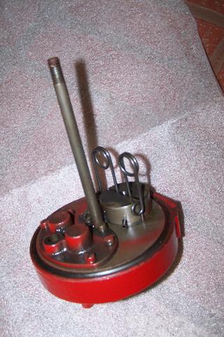

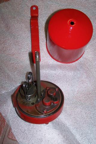

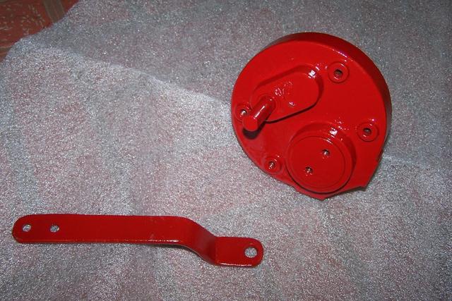

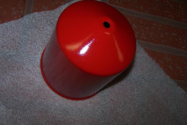

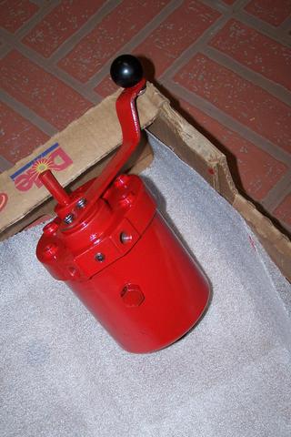

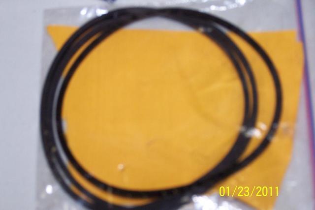

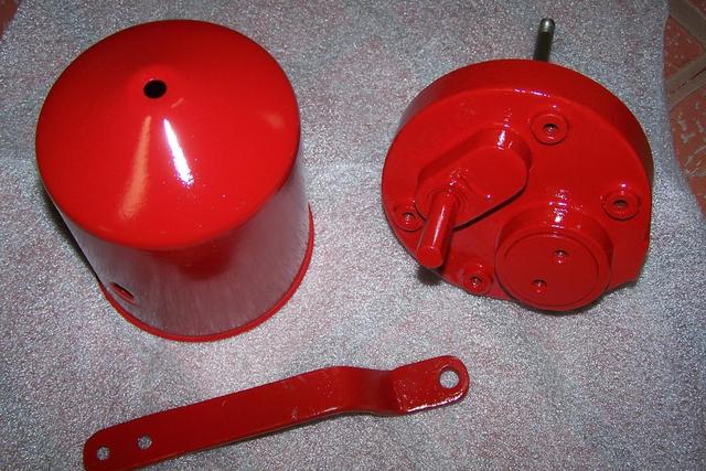

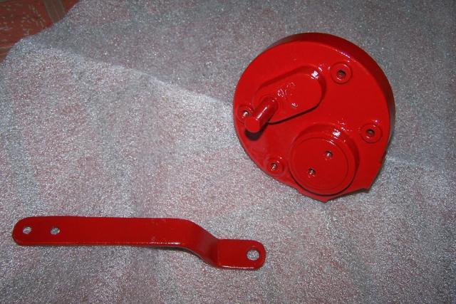

Lane Ranger 12,094 #5 Posted July 3, 2014 These pumps were on the 953/1054 and 1054 -A tractors and various other Wheel Horse models. Many of the pumps had pistons or cylinders that varied (along with the springs) depending on the model pump. Here are some of the old photos of the spring and O ring replacement on the early "rabbit ear" double spring in the 953 and some 1054 Hein Werner hydraulic pumps. Front of pump and handle Pump Fluid Canister (there is a gasket needed on this and you can buy it from the Cub Cadet guys website - as they used these pumps also -NLA fro m Toro) This is the Cub Cadet gasket for the pump fluid canister. The other type of spring on a Hein Werner Hydraulic Pump (The one on left was a previous owner's repair job of a rabbit ear spring that did not work) Photo of the piston and the new O ring and the steel retainer ring for the piston that rests on the piston outside the housing where the 1/2 inch shaft is (a pulley that the pump drive belt uses rides on the 1/2 shaft with one flat side and a set screw) Share this post Link to post Share on other sites
ol550 878 #6 Posted July 4, 2014 Don't forget there is a relief ball and spring. Broken spring = low pressure. 1 Share this post Link to post Share on other sites
