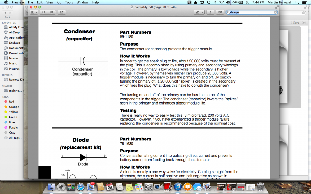

Martin 2,133 #5 Posted June 30, 2014 (edited) the glossary is where i got that info. not sure if there are different versions, i use this one..... REALLY GOOD way to learn about the electrical components and wiring on our tractors....... Edited June 30, 2014 by Martin 1 Share this post Link to post Share on other sites
