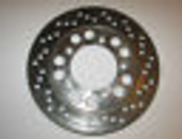

Horse46 519 #120 Posted January 21, 2015 I was thinking you could make one of you wheel centres and bolt weld?? to the centre of a disc like this ( if it was small enough to fit) just an idea of course, not really thought ot out properly, but who knows food for thought. 1 Share this post Link to post Share on other sites
Jparkes43 329 #121 Posted January 21, 2015 (edited) yes but i was thinking if you made one it wont be vented (yes you could slot and drill it) but not vented and at why not speeds that might be a problem? because it will over heat? james but ive never tried to make one i mean you could try!! Edited January 21, 2015 by Jparkes43 Share this post Link to post Share on other sites
