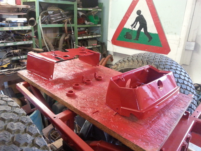

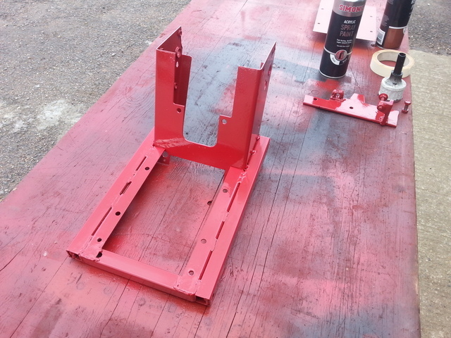

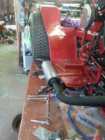

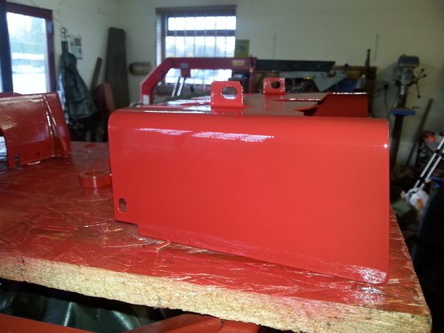

Stigian 1,235 #351 Posted April 3, 2016 Evening all, well the air around the workshop has been red of late... Nope, not people getting angry, chassis painting instead Two coats of Ford Cardinal red and a couple of clear coats.. Even though the engine cradle was painted at the same time, a different light makes it look a different colour! Out in the sun the red looks quite bright and contrasts well with the black radiator mount. The engine after 2 of 4 coats of black engine enamel. 4 coats of black done and the engine looks a lot better.. I didn't see any point in masking up the valve covers as they need to be stripped of silver paint and polished up.. Just so I could say I've started putting WN back together the king pins/spindles and rear axle were bolted on. When the engine and wheels go back on tomorrow I will really feel like I'm getting somewhere with the reassembly... Well, until I have to start on the bodywork 6 Share this post Link to post Share on other sites

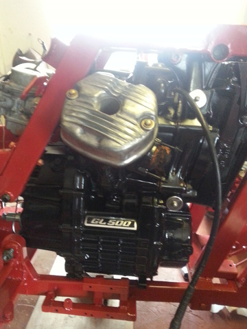

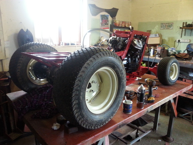

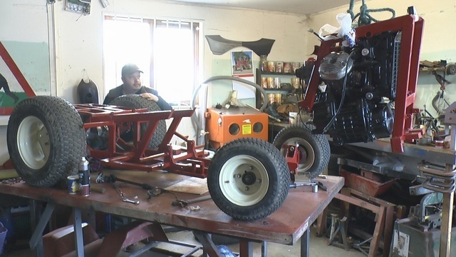

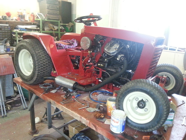

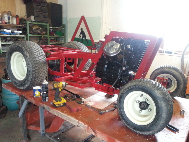

Stigian 1,235 #353 Posted April 10, 2016 On 03/04/2016 at 0:39 AM, pullstart said: I've said it before, and I'll say it again.... "OOOOOOHHH SHINEY!" Looks great Ian, keep up the good work! Thanks Pullstart, the good work will be kept up A big moment was reached Tuesday... With the help of Nigel, Matt, Dennis and Dennis's engine hoist (thanks guys) the engine went back in with only the minimum of paint damage.. To add a bit of detail the GL500 badges were cleaned up an repainted.. Most of Friday was spent painting bit's black or red.... It will be interesting tomorrow to see how the clear coats have settled. If all looks good I can start bolting some more parts back on.. For those who like their updates to be moving pictures, here's the latest WN video... Enjoy 3 Share this post Link to post Share on other sites
Stigian 1,235 #354 Posted April 17, 2016 Not a great deal to report, lot's of painted parts have been bolted back on... The valve covers were swapped for the one off my spare CX engine as furry is easier to clean... Lot's of polishing later... More Ford Cardinal red paint has been ordered, so next week the body panels get the treatment 4 Share this post Link to post Share on other sites

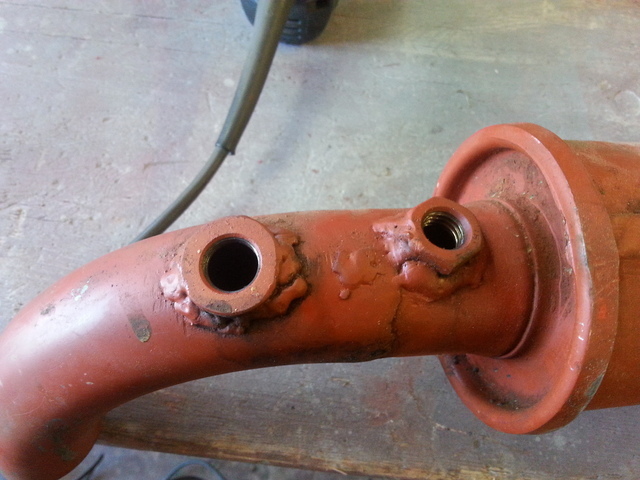

Stigian 1,235 #355 Posted April 28, 2016 Well... Everything I need to finish off the bodywork has arrived, filler, primer, topcoat etc but I found a slight problem! As I started to clean up the fender pan I kept finding more and more stress cracks! I'm not surprised as WN has had a huge amount of being thrashing about and the arch bits of the fender pan were not as strong as they could of been.. The hard part was coming up with a way of adding strength that didn't change the look of the fender pan... Until... A few welding burn marks! I need to tidy up a few welds but you won't see the strengthening frame unless you on your hands and knees looking under the arch.. Oh, and it's added a huge amount of strength that should stop things from flexing The underside of the fender pan has been cleaned up and red oxided.. Filler on, filler off! I hate fillering but it's got to be done.. The bonnet got a light skim of filler too.. The extra cooling slot I cut in the front were made wider so they match the originals, a new bit of "grill mesh" was fitted behind as well.. The top of the bonnet/hood had got to the point where it looked good and felt smooth.. Only one way to find out, hit it with primer.. Which I did and left it to dry overnight. Much to my shock the next day I found only a couple of high spots, a small low spot and a few pin holes in the filler.. So... More sanding, 3 good coats of primer, flatten back the primer and hit iot with 3 more good coats..... A bit of wet and dry work today will leave a very nice smooth finish for the top coats I have been working on the smaller panels as well, a bit of sun to help dry them.. Quite fun as I had to keep moving bits inside to avoid rain/hail/snow showers! Here's the next shower approaching! Getting the front of the hood looking good has been interesting, lot's of fiddly corners to flatten down. You can see where I have started smoothing out the primer with the help of a guide coat.. And that's the state of play at the end of today... I'm now away from the workshop for 4 days, it's going to be nice to get away from all that filler dust! 4 Share this post Link to post Share on other sites

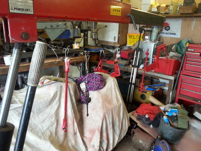

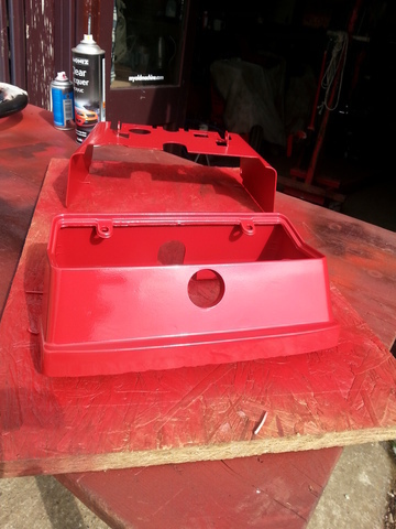

Stigian 1,235 #359 Posted May 22, 2016 On 08/05/2016 at 0:17 PM, 19richie66 said: I love it! That thing lookes wicked sitting on the table with the motor in it and no hood. Gonna look really nice when you are done. Thanks Richie, the black and the red do work well together Time for a well overdue update starting with...... A quick lesson in WHY NOT to rush a paint job!! The ally dash surround and fuel tank holder thingy were both painted in a rush of enthusiasm so I could see what they looked like with the top coats on!! Too much paint/not enough drying time/not sanding the primer coats looked just fine once the paint was on... However Monday I uncovered Why Not only to find the paint had sunk and cracked in places!!So yesterday I pulled the parts off to strip them of paint and start again!!! So remember kids, don't rush a paint job!! Finally panel painting time had come Yes I know it's hard to believe but Nigel was actually moving so fast he had started to blur Speaking of blurred, sorry for this naff photo.. Just when I thought I had finished with the red paint I found a rather large deep scratch in the freshly painted fender pan on Monday!! But somehow with some careful wet n dry work and some more paint the scratch vanished.. The wheels had got chipped with all the test driving so the paint was flattened back.... Here's the rears.. One front and two rears after a fresh coat of International Harvester White.... In a week or so they will be pin striped 3 Share this post Link to post Share on other sites

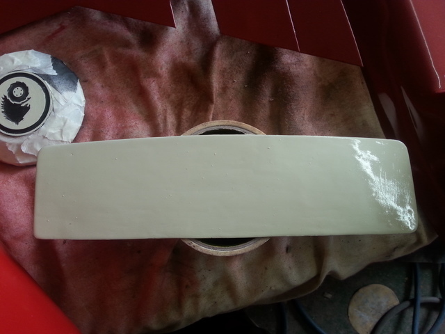

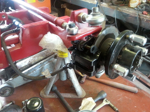

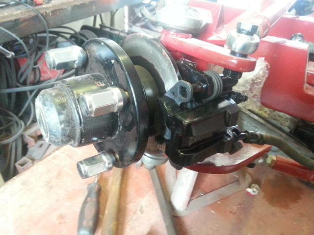

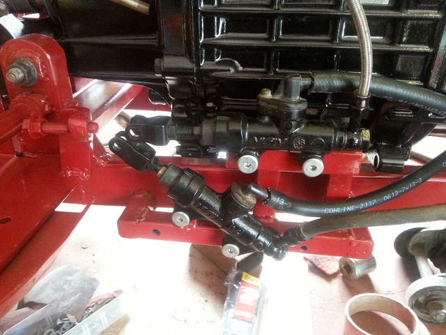

Stigian 1,235 #360 Posted May 22, 2016 (edited) The braking system has been cleaned up and painted.. Here's the two master cylinders... The brake calipers and mountings got the same treatment. I still need to bleed the air out the system, always a fun job with lot's of fresh paint nearby! The headlamp blanking plate was rubbed down, repainted, mud somehow stuck in the fresh paint, left to dry, rubbed down yet again and repainted again! For some reason this small panel has been the most troublesome paint wise and as you can see it's still not looking great! The white on the steering wheel center had faded quite a bit, so I gave it a careful repaint in IH white... I don't want the gloss look so the white will be very carefully flattened back to take the shine away. Not a great deal left to do really, bleed the brakes, finish the wiring, sort the exhausts out, bolt a few more small parts on.... Not much really.. Edited May 22, 2016 by Stigian 3 Share this post Link to post Share on other sites

Stigian 1,235 #363 Posted May 26, 2016 On 22/05/2016 at 7:51 PM, elcamino/wheelhorse said: You are a wonderful instructor, show the problem and how to fix it. . Great pictures. Thanks Jim.. A wonderful instructor!! That's a first On 24/05/2016 at 11:32 AM, pullstart said: Thanks for the update Ian, I can't wait to see it all back together and going [stopping too] again! Your welcome Pullstart.... Funny you should mention stopping... Tuesday was bled the brakes day.. The rears which were empty of brake fluid bled really easy, which was nice.... The fronts for some reason just didn't want to let fluid through! Lot's of faffing about including checking the calipers were actually working (they were) produced almost no brake pressure! So... I moved the master cylinder up in line with the rear cylinder to give it more pedal leverage..... Now the front brakes work really well Oh... And this also happened Today has been exhausting.... Yep, it's sort the pipes day Once all the extras for the non working flame/smoke making system had been removed the pipes looked a lot cleaner. Only these two holes to sort out.. That's better, just the welds to clean up.. Out came a spare muffler so I could measure out and make something I've been planning to for a long time.. Before the photo's a big thank you to Nigel for helping out with the exhaust wrap, a nasty itchy job that left us with itchy black stained hands! So thanks again mate 4 Share this post Link to post Share on other sites

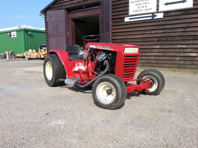

Stigian 1,235 #366 Posted June 6, 2016 On 30/05/2016 at 4:48 PM, Cheetah said: I just read through this thread, and what you done here is really amazing!! I showed a friend your muddy pic, and he just about fell on the floor on account he was laughing so hard Thanks Cheetah, I hope your friend didn't hurt himself when he fell to the floor Well Thursday was a very good day when a parcel containing custom decals arrived from Mark.. Perfect timing as it happened as all we had left to do was get WN off the bench and put some fluids in her.. So, a big Mark for the great decals, the cream rather than white works really well I guess now's a good point to do the "before and after" thing As arrived from Chris's collection.. The green engine wasn't part of the deal, I just needed somewhere to put it The same machine after a bit of work All I need now is a better seat... 7 Share this post Link to post Share on other sites
