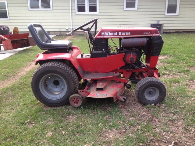

I just had a muffler go bad on my 312-A so im looking for a replacement. I found direct replacement new but in the $165+ range. Does anyone have any other options that they have found and are very happy with? Once I figured out my problem which took me very long time (never ever thought it was the muffler, it must be clogged) I was happy but didn't expect that big of a price tag for a new one.
I have found some aftermarket stuff that I could make work but none that are real close to the odd orientation of the horizontal style that came on it. I don't want it to look stupid and more importantly be much louder. I am going to take a better look at the muffler to see if I can easily cut it open to try to clean it out and then weld it back together but I thought I would try to explore other options first.

Please post a picture because it might help someone
that isnt sure of the specific muffler you speak of.

Your right I should have been more specific sorry about that. The engine is a Kohler Magnum. Part number I have found for the correct muffler is 94-3739.

update, I got my muffler fixed and saved myself some dough. im guessing I didn't get overwhelming responses because these probably rarely have issues but ill put out there what happened with mine.
The main intake tube which clamps to the outlet of the motor deteriorated and broke off inside. its capped off on the end inside the muffler so I think it was able to bounce the right way and wedge itself into a hole that's halfway down the muffler essentially blocking things off. I cut both ends off with a cutoff wheel at the rolled seems which allowed me to disassemble the entire muffler. I made a new inlet tube out of a piece of 1.5 o.d. pipe about 5" long. refit everything and welded it up and it works like a charm, nice and quiet.
I figured if I am just going to have to scrap it why not cut it apart and at least see how its designed? its a cool little setup and im glad I did because it was pretty easy to fix and I saved myself $175 bucks not having to buy a new one.
