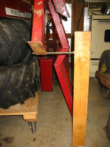

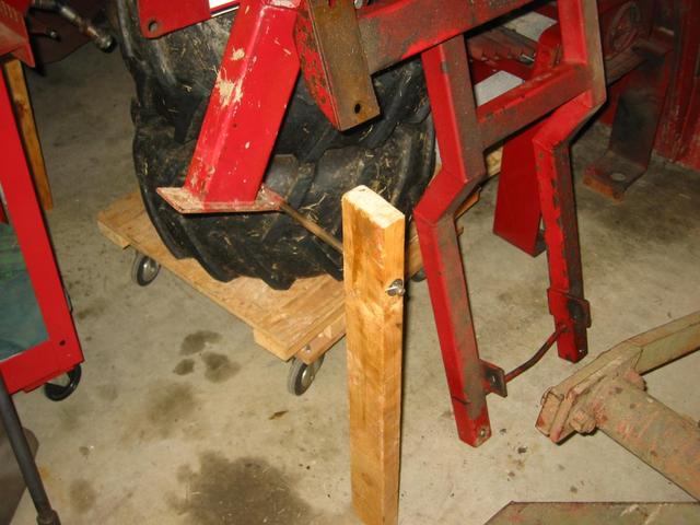

pfrederi 19,940 #15 Posted June 19, 2014 Here are my cheap homemade stands.Make sure that the 2x4 is long enough to allow the turning brake pedal to pass under the 1/2" rod. After the bucket is flat on the ground and you have removed the mounting bolts and hydro lines put the rod into the tube on the loader frame with the 2x4s angled. The stand on the tractor and lift up on the cross bar. The 2x4s will swing down to vertical and you can roll the tractor back out. 1 Share this post Link to post Share on other sites
the_nite_owl 15 #16 Posted June 19, 2014 Good tip, any picts of your modifications share here? I do not have pictures of the completed assembly yet. I have been working on trying to get the FEL working, the paint finished and the new decals on but I will put together pictures of the foot pedal assembly soon and post them.I have not yet built in a spring centering mechanism which I intend to do but have not had time. I may have to follow pfrederi's example here and make my own stands. This FEL is a nuisance to mount/dismount on my own and it scratches up the paint when I do. If the lift arms only cleared the wheels it would be easy. 1 Share this post Link to post Share on other sites
AMC RULES 37,254 #17 Posted June 19, 2014 Looks like it works perfectly Paul... some really good tips there. Share this post Link to post Share on other sites

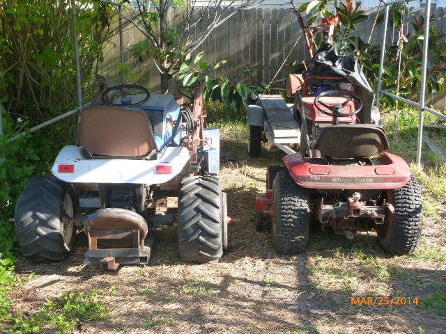

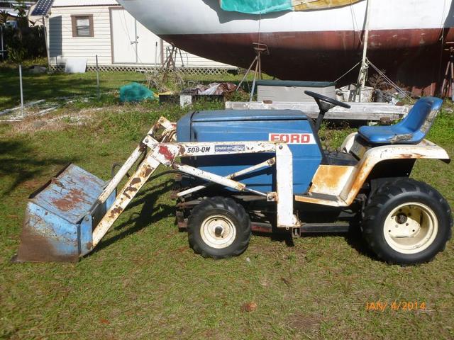

over60pirate 24 #18 Posted June 28, 2014 While looking for a loader for my 414-8, I found Ford LGT 165 with a Ark loader. It has foor pedals, which are great. The hydro on the Ford groans a lot under load, which makes me nervous, but have heard a lot of them do. The fluid is clean, so holding my breath. I really can't imagine mounting and unmounting the loader to use. I use mine for small jobs, andwouldn't be worth the trouble to swap it. Glad I have the 414-8 for mower and other uses, with a winch mount on front and back. FYI, the WH is much easier to work on. 2 Share this post Link to post Share on other sites
pfrederi 19,940 #19 Posted June 28, 2014 I doubt that Ford made their own hydro units. is it an Eaton or a Sundstrand??? Share this post Link to post Share on other sites
tomtractor 71 #20 Posted June 29, 2014 The ford has an eaton 11. I am thinking about getting a ford 165 - are you happy with it? Any things to watch out for? Share this post Link to post Share on other sites
over60pirate 24 #21 Posted July 2, 2014 Im happy with the Ford LGT 165, except for the fact that the hydro groans a lot under load. I think I would rather have a gear trans, like my WH 414-8 My Ford is a "closed side" model. I would rather have an open side model. On mime there is a sheet metal box, shroud between the motor and grill. You can't even see the muffler. I've heard steering box play can be a problem, and getting the box out is no picnic. Mine is ok. Share this post Link to post Share on other sites

over60pirate 24 #24 Posted July 15, 2014 As far as hydro or gear goes, my Ford LGT165/loader, has a hydro, with foot control, and it's real easy and fast to operate. I using the loader in a small area, I think a 1 hour job would take an extra 10 or 15 minutes, with a gear transmission. Share this post Link to post Share on other sites
