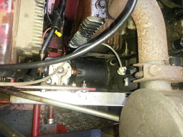

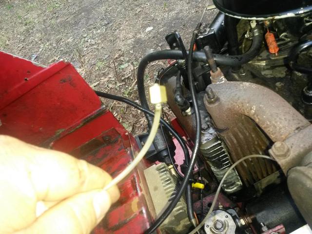

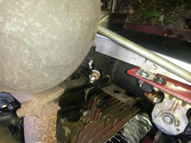

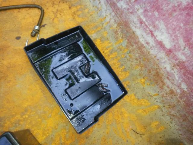

SousaKerry 503 #10 Posted June 17, 2014 Pictures of the mess and the temporary fix. All I could find was a shrader valve so it will have to do. Believe it or not I didn't even have to add any oil. Put it back together and finished the job. Share this post Link to post Share on other sites
