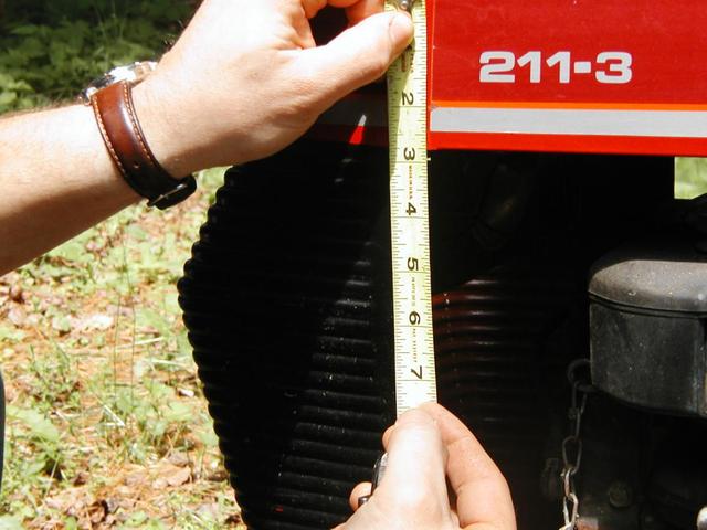

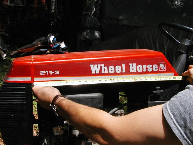

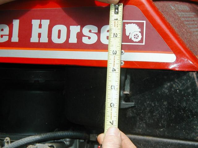

The 211-3 is a smaller machine than a 300/400 Series.   The hood is about 2 inches shorter.  The length along the bottom of the 211-3 hood decal is about 24 inches and the height at the front of the decal is about 21/4 inches.  The same measurements for the decals on the hood of the 400 series are about 26 1/4 to 26 1/2 by 2 3/8 depending on year.   If you need more precise measurements to make decals for the 211-3 let me know and I will take pictures with a tape against the decals.

Here are some crude pictures:
post-4541-0-54102900-1402922818_thumb.jp
post-4541-0-81699200-1402922833_thumb.jp
post-4541-0-94503900-1402922851_thumb.jp
