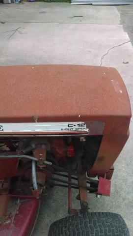

eosinophil 0 #3 Posted June 11, 2014 I just ran out and grabbed these - hope they post okay. I'll put a general picture next, thank you!!! I know it's rough - i'm okay with that i just want it to put it in the best shape possible. Share this post Link to post Share on other sites

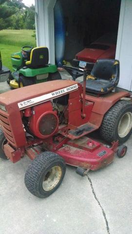

eosinophil 0 #4 Posted June 11, 2014 here's another view that lets you see the whole tractor. Again, thanks for any advice! eosinophil Share this post Link to post Share on other sites
Tankman 3,528 #5 Posted June 11, 2014 Horse looks great! I would repaint and of course, new decals. The decals come off easily, use a heat gun. I would send out, inexpensive, and have some parts sand blasted. I found it too difficult to remove rust mostly from inside the hood. Rustoleum Regal Red rattle cans do an excellent job. I like the color too. Have fun, your Stallion looks excellent. I see your other "thing" is green with envy! Share this post Link to post Share on other sites
c-series don 11,379 #6 Posted June 12, 2014 Ok here is my two cents. If you don't want to paint it I would buy a gallon of WD-40 and a spray bottle. Spray it and let it sit overnight or a few days even. Then wipe it clean and sand it with 600 grit or something even finer. Then spray with WD let sit,wipe off. Repeat this process a few times and you will keep the patina and get a low gloss/shine to it. I have done this to my C-161 and C-121 and am happy with the results. Also I spray WD on them and just leave it on there as long as you not mowing with it. Share this post Link to post Share on other sites
Martin 2,133 #7 Posted June 12, 2014 i wouldn't repaint. i think with some cleaning up you can get it to look better. you won't be able to save the paint on the hood, its too far gone. i think i would try what some on here do with the oil. I'm not exactly sure whats involved in that i usually only polish or strip and repaint. you could contact one of the experts on the subject, send them a pm and see what they have to say. i know stevebo is one of them, see what he says about it..... pm steve here...... once you click the link below, click on 'send me a message', I'm sure he wouldn't mind giving his opinion, great guy!!! http://www.wheelhorseforum.com/user/734-stevebo/ Share this post Link to post Share on other sites
doc724 925 #8 Posted June 12, 2014 Having bought a similar machine of the same vintage with about the same hood "patina", my experience is to pull it apart, get the rust off everything and repaint it. Trust me, your Dad may have taken extremely good care of the tractor, but the ravages of time cannot be stopped. You are going to find rust on the battery tray, the hood stand will be rusted where it bolts to the frame. There is a baffle under the shift console that becomes a collection point for grass, leaves and general dirt. Unless Dad was very fastidious, this will be rusty. Yes, taking the machine apart will be a big project, but these machines are pretty simple. You will receive a great level of satisfaction in restoring this machine to its former glory and you will have a renewed appreciation for the engineering that went into the design may years ago. My 1978 C141 is my favorite tractor. As I grow older, I will likely sell off my newer machines when I no longer have the need for them. However, the C141 will be the last to go. Share this post Link to post Share on other sites
kudzu3 323 #9 Posted June 13, 2014 Since it is in pretty bad shape, I'd try a good buffing with 000 steel wool and then a little time with a buffer and some good compound followed with a good wax job. I did this with a d 180 that was in similar condition, it certainly wasn't perfect but sure looked better than before. Share this post Link to post Share on other sites

eosinophil 0 #12 Posted June 13, 2014 Hi again - thanks for all the advice! I'm sure it's never been washed since my dad got it - Dad was not exactly into mechanical stuff! He had the lawn mower guy pick it up every season (maybe twice? I don't remember) and left it up to him to do whatever needed doing. Otherwise, Dad pretty much put gas in it and didn't think about it beyond that. So while it's been well maintained mechanically, well, you can see how it looks. Doesn't help that i've had it pretty much rarely used and just sitting in my barn the past couple years. I agree there's no way short of a real repaint to get it to look good, but I think I'll start out with the WD40. How much do i spray on it - so it's wet / puddly wet? I'll try that with the finer sand paper or maybe the steel wool and see what we get. Stupid question - what would you recommend for compound? I've never used one and there are so many to choose from!! I am more a patina than a showpiece kind of person (especially cause of the way I mow!) so i'll see what we get with that to start. I've read it's possible to get new seats so I think i'll look into that, too, as the ripped up one not only looks lousy it is godawful uncomfortable. I'll send pictures to show how it goes! thank you all for your input - i've been feeling guilty about not taking care of this and now I can feel better about it! Share this post Link to post Share on other sites
c-series don 11,379 #13 Posted June 16, 2014 I would WD it till it's good and wet then rub it in by hand with a latex/rubber glove, not a rag. Then let it sit for a day or so. I forgot what grit paper but just make it very fine, like said in my last post. I have never used compound for this so I can't help with that. This is not an instant gratification thing, I would repeat this occasionally over a couple a weeks. If you mow with it I would wipe it clean then wash it other wise dust will cling to it like a magnet. Upon storing WD it again. This has worked for me,I hope it works for you. Please post pics with progress good luck ! Share this post Link to post Share on other sites
oneroadkingman 53 #14 Posted June 17, 2014 welcome to the family. well looks like you got a good start for a tractor I would try the wd-40 method first if you don't like it I guess then paint it. Share this post Link to post Share on other sites
