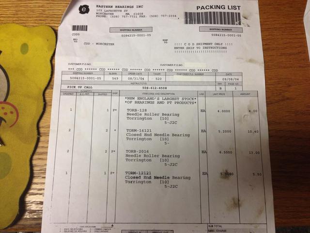

Tim 97 #6 Posted June 9, 2014 when I rebuilt my tiller I bought all of the bearings and seals from a local shop. they were the exact same thing that WH used (torrrington bearings) the cost was about 1/3 what the dealer had Share this post Link to post Share on other sites

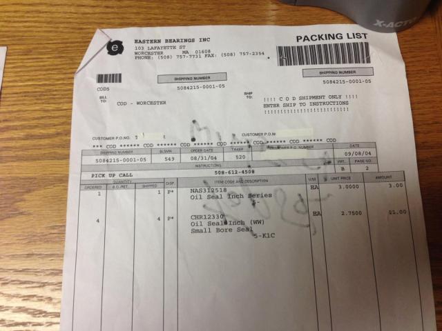

Tim 97 #9 Posted June 17, 2014 I still have the receipt of what I bought but the part numbers seem specific to the place I bought them maybe it will help Share this post Link to post Share on other sites
Tim 97 #10 Posted June 17, 2014 the older instruction manuals had a better description of the parts I think they are the same back then as they were in 1991 the 1991 manual had very generic descriptions Share this post Link to post Share on other sites
fedrailcar 0 #11 Posted June 18, 2014 Well guys I think I have it figured out now I took all my parts and prices to the local bearing supplier and we mic'ed everything and come up with every bearing and seal I needed. And believe it or not it was on 60 bucks. That was for every bearing and seal in the thing. *peices Share this post Link to post Share on other sites
