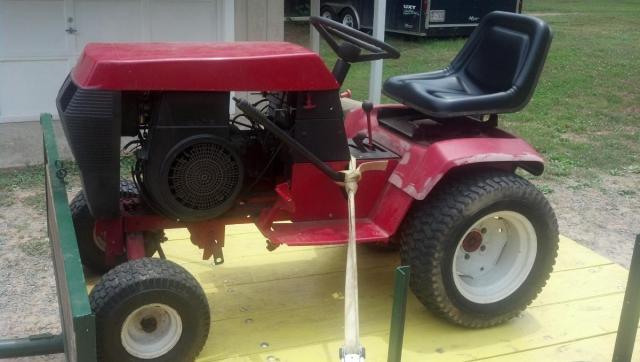

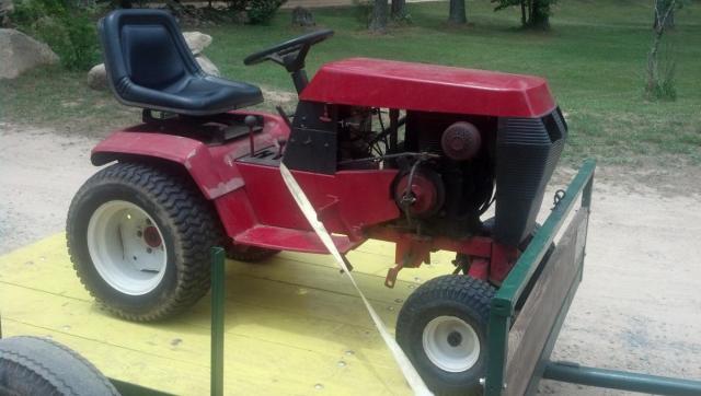

Wheel-N-It 2,978 #1 Posted June 9, 2014 Here is the latest score. I have been looking for a good 16hp Magnum for over a year now (can't have too many) to install in my C-165. Also was needing a nice padded high back seat to as a replacement for the 414-8 that I purchased right before the Big Show last year. I found this one within an hours drive from my house. It was a Father / Son project. The Son lost interest first and then the Dad. After getting it home and learning how to adjust the governor, and change the oil, I am happy to report the big Kohler runs nicely. It fires right up hot or cold, does not knock or smoke. It will be the perfect replacement engine for my C-165 Black Hood that I am so fond of. Then I will have a rolling 300/400 chassis to pick parts from. I do have a question for those of you who know more about the 300/400 series of Wheel Horses than I do. There is no ID anywhere. It has the 8 speed with 1" axles. It has the 22" tall tires on the rear like a 310, and the 6" wheel in front like a 310 or 312. It has an hour meter on it like a 312 or 416. So could such a Wheel Horse have come from the factory equipped like this? If so, what is it? A 316-8? A 416-8 (down graded)? Or is it a 310-8 with an engine transplant, which is what I am thinking it is. Anyway, what is your opinion? Thanks, Van 1 Share this post Link to post Share on other sites

papaglide 542 #3 Posted June 9, 2014 (edited) That's a sleeper tractor! Like a Plymouth Duster with a big engine. Looks like your average 310 until you look under the hood, then you know she means business!! I am agreeing with you, a 310 with a transplant. Edited June 9, 2014 by papaglide 2 Share this post Link to post Share on other sites
leeave96 496 #4 Posted June 9, 2014 Van - I'm thinking the tractor's been repowered. Are you certain the engine is a M16? Share this post Link to post Share on other sites

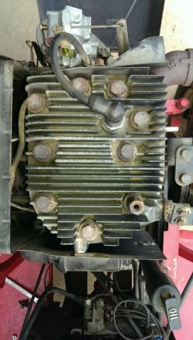

Wheel-N-It 2,978 #6 Posted June 9, 2014 I may be able to remove just enough overspray on the engine lable to see whet the spec numbers are. Bill, I'm sure its an M16. There are 9 bolts holding the cylinder head to the block. Check out the pic below. Also check out the shiny new Wallbro. Share this post Link to post Share on other sites
buckrancher 2,696 #7 Posted June 9, 2014 312/310 transplant 1 Share this post Link to post Share on other sites

oldredrider 2,553 #9 Posted June 9, 2014 K series 16's have 10 bolt heads. Not sure on the Magnums..... Share this post Link to post Share on other sites
Wheel-N-It 2,978 #10 Posted June 9, 2014 K series 16's have 10 bolt heads. Not sure on the Magnums..... Well I stand corrected. Thank you OldRedRider. I just looked at the Magnum service manual. Low and behold its not a M16. The M16's all have 10 head bolts. Of course I still can't complain. Its a good running engine, and I only paid $200 for the whole tractor. As far as I am concerned though, that M(whatever it is) will still be transplanted to the C-165. I learned something new today !!! Share this post Link to post Share on other sites

tbarnhart 240 #14 Posted June 10, 2014 A quick way to tell the 16 hp motors is the exhaust port. The 341/m16 have 1-1/4 pipe threads instead of the 1 on the 10, 12, and 14's. 1 Share this post Link to post Share on other sites

Wheel-N-It 2,978 #18 Posted June 12, 2014 Thank you TBARNHART. You jogged my memory about the upsized exhaust outlet. This is true. Bill, Thank you for that helpful hint. I need to verify what I discovered last night. I put the mystery tractor in the shop last night and went to work removing overspray from the decal located just behind the throttle/choke linkage near the fuel pump. The engine is a 12 horse power Magnum. So now I'm thinking the tractor is a 312-8. As I posted earlier I'm still not disapointed due to the fact the engine runs really well and I transplanted it's seat to the 414-8. I have a nice Wheel Horse muffler sitting in the shop that I could put on this engine to make it more pleasing to my ears, however I beginning to rethink the transplant of this engine to the C-165. Its just too nice of a tractor to not have at least a 16hp powering it. Maybe I'll think on this some more at the Big Show Share this post Link to post Share on other sites
bo dawg 565 #19 Posted June 12, 2014 I would guess 312-8 1 Share this post Link to post Share on other sites
