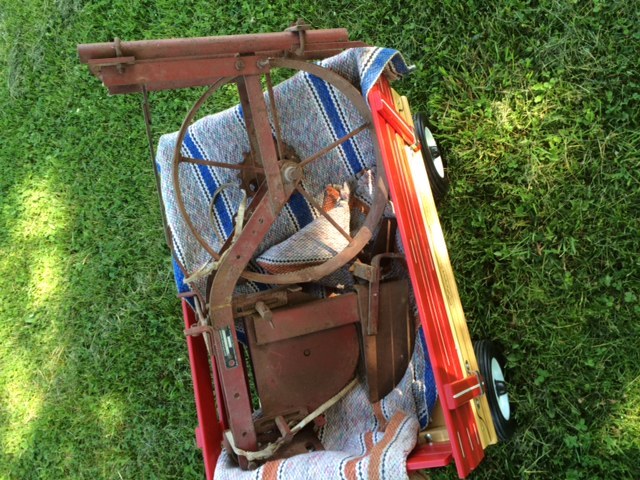

brandon701 23 #1 Posted June 8, 2014 I picked this up at an auction this past week and was wondering if anyone has a manual on it? Also how does it hook to the tractor. Any help is appreciated. Thanks Share this post Link to post Share on other sites
tbarnhart 240 #2 Posted June 8, 2014 I'm not sure what tractor you're planning on using that planter with, but it looks like everything is there to hook up to a sleeve/brinly hitch. The hinged fold-down bracket on the front bolts directly to the back of the sleeve hitch. I think you use the sway control bolts but bolt them in from the back side. The tubes in the rear are part of a fertilizer attatchment. It looks like you are missing the hopper and the metering parts. Good luck Share this post Link to post Share on other sites
