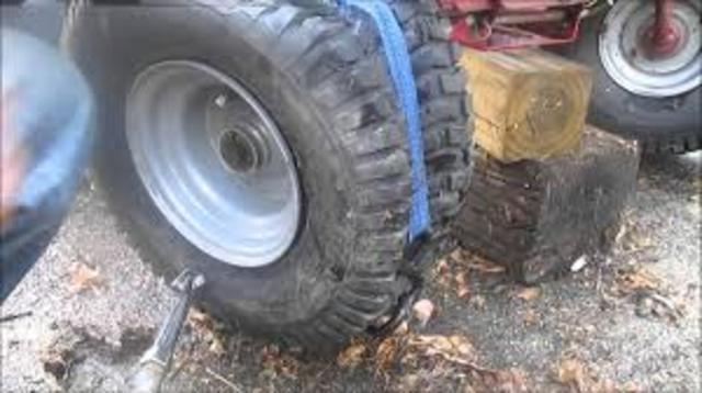

TDF5G 2,074 #38 Posted October 23, 2015 Sometimes a strap tightened around the tread of the tire can be used to seat the beads. Like a ratchet strap, or improvise a rope twisted with a board or chain, etc. Might save a trip to the tire shop. Also spreading the bead a day or two before mounting helps. Use blocks of wood stuck between the beads or an inner tube aired up in the tire, if you have one on hand. Be sure to remove the valve core from the stem when seating beads to get more air volume in the tire also. Share this post Link to post Share on other sites
stevasaurus 23,859 #39 Posted October 23, 2015 (edited) I can't believe I am doing this. https://www.youtube.com/watch?v=cpu-OZhRrT0 Edited October 23, 2015 by stevasaurus 1 Share this post Link to post Share on other sites
Brian01 481 #40 Posted October 23, 2015 Okay, now, I'm a country boy, but that right there is some deep woods hillbillies puting a tube in a tire! 2 Share this post Link to post Share on other sites
