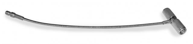

KC9KAS 4,746 #2 Posted June 6, 2014 (edited) This holds the valve in place while you install the tire. Remove this tool and HOLD the valve stem with 1 hand and air it up with the other hand! Edited June 6, 2014 by KC9KAS 4 Share this post Link to post Share on other sites

KC9KAS 4,746 #13 Posted June 6, 2014 Google is your best friend. https://www.google.com/search?q=tire+tube+puller&source=lnms&tbm=isch&sa=X&ei=RyeRU-LVL82ZqAb464HIDA&ved=0CAYQ_AUoAQ&biw=1280&bih=887 This is the actual tool I have! Just didn't spend a lot of time on GOOGLE to find the valve too! Thanks! Share this post Link to post Share on other sites
