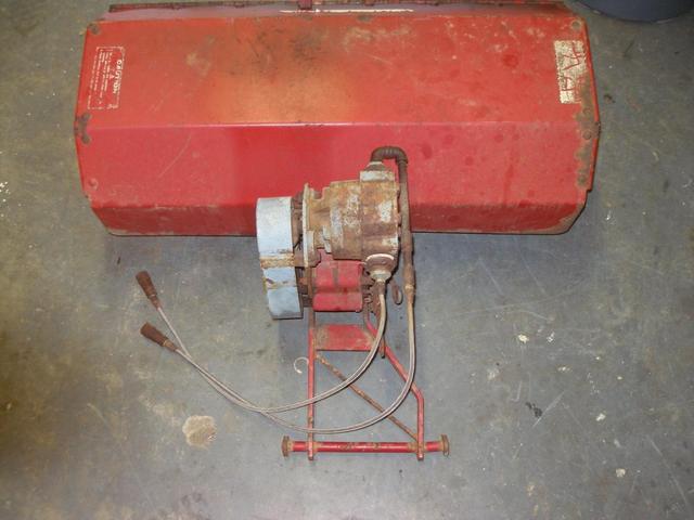

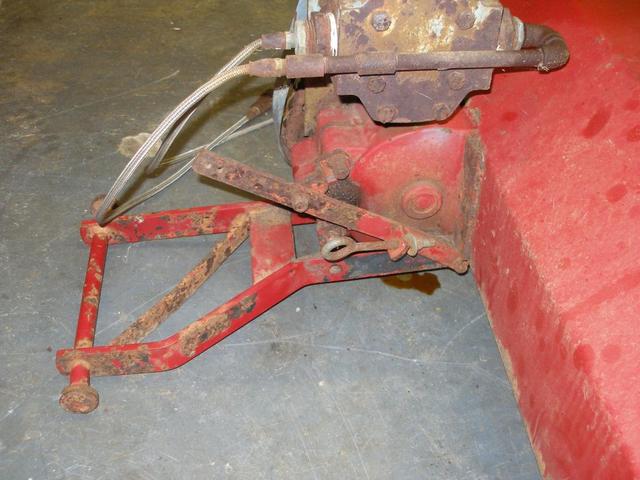

gatoolman 0 #1 Posted June 2, 2014 Hello to all. I have a hydraulic driven Tiller that I can't find any info on. No markings that I can read on the tiller other than a Delta Hyd made in Rockford, Il tag on the hyd. motor. I looked through the on line manuals posted and got a pretty good idea of the brackets to mount but don't realy see how I would attached the tiller to lift it up. The tiller looks like it was only used a few times and has most of the paint on the tines so I would like to try and use it if possible. Any help is greatly appreciated. Share this post Link to post Share on other sites

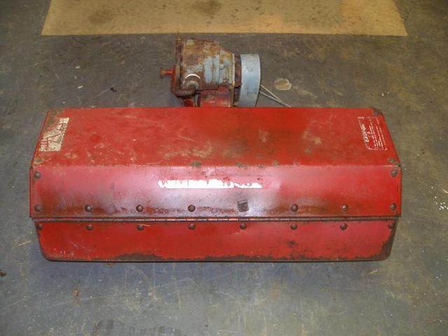

gatoolman 0 #2 Posted June 2, 2014 It is a 36" Tiller Share this post Link to post Share on other sites
Desko 624 #3 Posted June 2, 2014 That tiller is for c,300,400, and 500 series that someone put a hydro pump on. Share this post Link to post Share on other sites

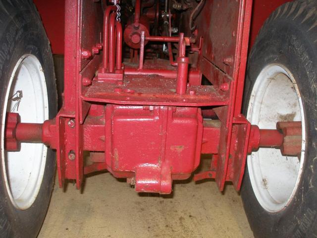

brandonozz 168 #5 Posted June 4, 2014 That tiller is designed to connect to the bracket that mounts under the transaxle - the same mount used for the push / snow blade. The D series use a 3 point lift for the rear and was powered with a PTO shaft. My understanding the D 200's came standard with the 3 point but had to be added to / purchased for the 160's and 180's. When installed, there is a second lift cylinder on the right side of the tractor under the seat used to lift the 3 point. Share this post Link to post Share on other sites
gatoolman 0 #6 Posted June 5, 2014 Thank you for your reply. I don't think I'll be spending the money on a rear PTO or a 3 point hitch so on to plan B. Share this post Link to post Share on other sites
