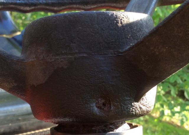

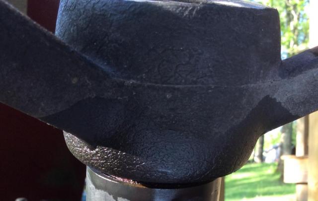

Graeme 7 #1 Posted June 1, 2014 Hi all, I sorry to rehash a well worn and well discussed topic, but after reading all I could I am yet to find my answer. I have a 1987 416-8 with a sloppy steering wheel. I found that where the upper shaft goes through the thin dash metal the dash is cracked. I intend to pull the steering wheel and install flanged bearing #6472 after welding the cracked dash plate back together. I feel fairly confident in pressing the wheel off the shaft. I have a 20 ton press at work and feel pretty well versed in pressing, my question lies in the roll pin that secures the steering wheel, I can only see one hole in the lower part of the steering wheel where the roll pin goes in. I am reluctant to try to drive the roll pin when I can't see anywhere for it to go. There is no hole on the opposite side of the lower part of the steering wheel for the roll pin to exit when driving it through. What am I missing? I'll attach pics in a minute. If I switch to camera my writing will disappear. Thanks all you gurus, in advance. Share this post Link to post Share on other sites

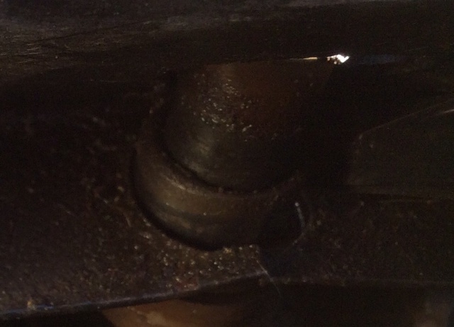

Graeme 7 #2 Posted June 1, 2014 Here are pics of the steering wheel pin, the opposite side, and the cracked dash. 1 Share this post Link to post Share on other sites
Kelly 1,033 #3 Posted June 1, 2014 (edited) You may have to cut a hole in the rubber, I have never seen one with out 2 holes, but some have just been a small hole, I like to use a roll pin punch made to go in a airhammer, 99% of them pop right out with it. Edited June 1, 2014 by Kelly 1 Share this post Link to post Share on other sites
daveoman1966 3,839 #4 Posted June 1, 2014 (edited) On more than one occassion I have used a 20-ton press to SHEAR off the roll pin in this kind of s/wheel. If you can get the s/wheel and column out of the tractor, wiggle it into your press and shear the roll pin. It'll make a floor-shaking BANG when it shears, but it gets done. Then you can just knock out the pieces of the roll pin. That roll pin is very hard and, by nature, very brittle so it will break / shear off. Edited June 1, 2014 by daveoman1966 Share this post Link to post Share on other sites
AMC RULES 37,196 #5 Posted June 1, 2014 Drill an exit hole on the other side... bet it pushes right out. Let us know how it works out. Share this post Link to post Share on other sites
Graeme 7 #6 Posted June 1, 2014 I am correct in assuming this is a roll pin, right? Hard to tell whats in there behind all the rust. Share this post Link to post Share on other sites
AMC RULES 37,196 #7 Posted June 1, 2014 Yep, it is. Share this post Link to post Share on other sites
