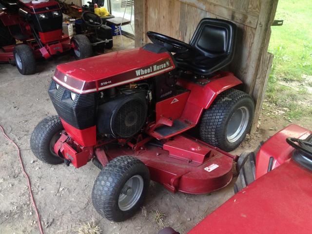

Bert 775 #1 Posted June 1, 2014 Hello folks, the 518 that i was going to convert into an 8speed didn't ever work out. What happened instead was i found a 520 hc close to home with rusted paint, grenaded engine and bad frame (from engine plate not tight). I swapped the hc running gear, hydraulics and all the other bits n peices onto a 414 8 frame then finished it off with the onan and 518 sheet metal I like it! 8 Share this post Link to post Share on other sites
Wheel-N-It 2,978 #2 Posted June 2, 2014 Good work on that conversion. I like the 60" mowing deck you installed on it too. Share this post Link to post Share on other sites
Bert 775 #3 Posted June 2, 2014 Thanks for all the likes I've gotten on this one. Wheel-N-It I like the behemith deck to, surprisingly the missing two hp hasn't been that noticeable. Share this post Link to post Share on other sites
546cowboy 302 #4 Posted June 2, 2014 Well you know I've been mystified as to where that 2 H.P. comes from. The bore and stroke is the same on both the P-218 and P-220. Maybe some expert will chime in here. The only thing I could see doing that would be the cam. I don't believe the carbs or valves are different. Share this post Link to post Share on other sites
MalMac 1,334 #5 Posted June 2, 2014 I know sometimes the way head's are configured affect compression, can change HP. Share this post Link to post Share on other sites

ericj 1,579 #7 Posted June 2, 2014 the 18 hp uses the 16 hp cam and carb and the bottom end of the 20 eric j Share this post Link to post Share on other sites
Bert 775 #8 Posted June 2, 2014 So if i put the carb off the dead 20 house on the 18 would i get more power? Or would it run rich with the smaller cam? Share this post Link to post Share on other sites
ericj 1,579 #9 Posted June 3, 2014 i've never tried it so it might just over carberate the motor and not run good at all or it just may run good if you try it give me some feed back and let me know how it does for you eric j Share this post Link to post Share on other sites
