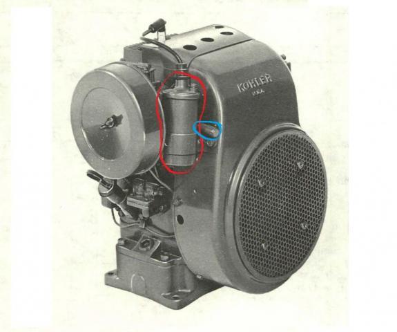

Sparky-(Admin) 24,769 #3 Posted May 31, 2014 The item the fuel line goes into before the carb is the fuel pump. The small silver cylindrical item is the condenser, the small cover its attached to should have the points underneath. What I don't see is a coil. I wonder if this was originally a magneto ignition motor and someone started swapping it to points/coil/condenser. Mike.......... Share this post Link to post Share on other sites
LindsayLaperr 5 #4 Posted May 31, 2014 Can you send me a picture of what it should look like (the coil) ..? Thanks for the reply!!!!!! Sent from my iPhone using Tapatalk Share this post Link to post Share on other sites
Sparky-(Admin) 24,769 #5 Posted May 31, 2014 Here's a pic. The coil is circled in red and the condenser is circled in blue. Mike.......... Share this post Link to post Share on other sites

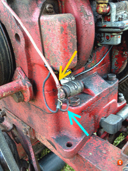

Save Old Iron 1,573 #8 Posted May 31, 2014 (edited) Lindsay, this is very unusual and therfore quite interesting. 3 wires going to the condensor. 1 wire would be the norm for standard coil ignition Can you post a picture of where the white wire (yellow arrow) leads too? Also post a pic of where the lower blue wire (blue arrow) leads to. Edited May 31, 2014 by Save Old Iron Share this post Link to post Share on other sites

LindsayLaperr 5 #10 Posted May 31, 2014 Yep. Curious isn't it?! The white (it's actually orange) is going to the brake --- and the blue is heading in under the flywheel cover Sent from my iPhone using Tapatalk Share this post Link to post Share on other sites

Save Old Iron 1,573 #12 Posted May 31, 2014 (edited) Did you find the location of the ignition coil asked about in an earlier post ? post a pic of the coil please. I can't think of any reason the ignition system condensor should be connected to the parking brake wiring. I'm betting it is a kill wire ? for the magneto ? sorry to ask for so many pics but you do have some strange wiring connections in the ignition system. Edited May 31, 2014 by Save Old Iron Share this post Link to post Share on other sites

Save Old Iron 1,573 #14 Posted May 31, 2014 (edited) thanks -understood. don't worry about the noobie stuff. half the fun of this is the "long distance" troubleshooting process. this wiring to the condensor has my interest piqued right now - especially the orange wire leading off to the brakes. Edited May 31, 2014 by Save Old Iron Share this post Link to post Share on other sites
Save Old Iron 1,573 #15 Posted May 31, 2014 (edited) No coil! Magneto. Looking at your original pic post, the spark plug wire does disappear into the flywheel area. Finding out what is at the other end of spark plug wire will tell us what you have for an ignition system. Looking back over your first post, if the tractor has been sitting outside for any extended period of time, you may want to reomve the flywheel shroud to clean any debris or nests that may be blocking the cooling fins on the engine. Removing the flywheel shroud will also expose the igntion system for identification and inspection for any possible rodent damage. Edited May 31, 2014 by Save Old Iron Share this post Link to post Share on other sites

gwest_ca-(File Mod) 12,067 #22 Posted June 4, 2014 The 3 different ignition systems are described in this manual Section 6 If you follow the light colored wire that is connected to the condenser back to it's origin does it go to a terminal on the ignition switch identified with an M for magneto? Garry 1 Share this post Link to post Share on other sites
LindsayLaperr 5 #23 Posted June 12, 2014 Anyyyyway, that carb finally got it's full clean and the thing runs like a champ - I think the starter needs to come off for a rebuild and probably change the transmission fluid --- it IS a magneto, points, condenser set up. I'll post a video soon, best day ever hearing that guy fire up. Goona post an "in search of" some parts I'm looking to replace - it is close, I think I got a killer deal cause it didn't take much to get it going and it sounds great. Thanks for all your help guys! Sent from my iPhone using Tapatalk Share this post Link to post Share on other sites
