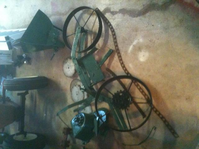

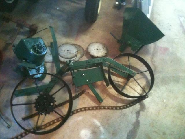

ricksrj58 273 #1 Posted May 26, 2014 (edited) anyone have pics of the sleeve hitch mount?1000.photobucket.com/user/ricksrj58/media/DSC00373_zps69e6738f.jpg.html] Edited May 26, 2014 by ricksrj58 Share this post Link to post Share on other sites

joel_400 59 #3 Posted May 28, 2014 What company made that planter? I have one exactly like it with a david bradley name plate on it. However it is setup for three point sears/late david bradley. I would like to try to find more seed plates for the one I have. Joel Share this post Link to post Share on other sites

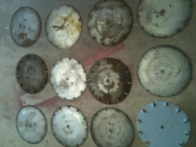

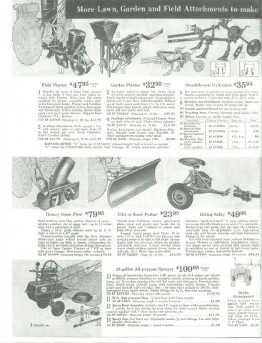

Lane Ranger 11,814 #4 Posted May 31, 2014 (edited) I have a two wheel push version of this seeder. It is a David Bradley but was made by a company in Danville, Illinois (may have been named Colvin??)that is still in business but no longer makes seeders. The 1961 (or 1962) Sears Catalog has two versions listed. The first page of the Sears catalog has the two wheel chain driven version. The planter opened up the furrow or planting row, dropped the seed (using a plate -there were 11 sizes for various types of seed, and then the row was closed and covered with soil as you pushed (or in the case of the tractor version pulled) the seeder. Here are the two pages of the Sears catalog with the prices and more details. Make sure to take a look at the prices of a lot of other neat things in 1961! I have 12 seeder plates but found out this am looking at them that there are two -D-12 versions. I am placing new hardwood handles on my David Bradley seeder. This is my seeder project: Edited May 31, 2014 by Lane Ranger 2 Share this post Link to post Share on other sites

jwl 75 #9 Posted June 1, 2014 Do you have any duplicate plates you would part with? I only have the one plate that came with mine. Joel Last yr there was a guy selling new plates on Ebay. They looked pretty good, but since I have 2 full sets of 11 and some extras I use in the garden, I didn't need to get any right then. If you can find C,D,E and F12 that's ones you mostly need to plant a garden with. The rest are tiny or giant holes, and I found that one of my Planet jr's worked better. Also for those who didn't know, Planet jr seeders were used on some WH and other models of GT's. Most of the time its a 300A, sometimes its a 300, and once in a while its was a model 4 or 25. Like the Danville seeder, once again its the hitching that makes it work on with a certain tractor, the seeder units are always the same. 2 Share this post Link to post Share on other sites

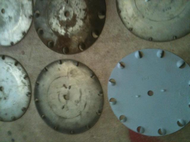

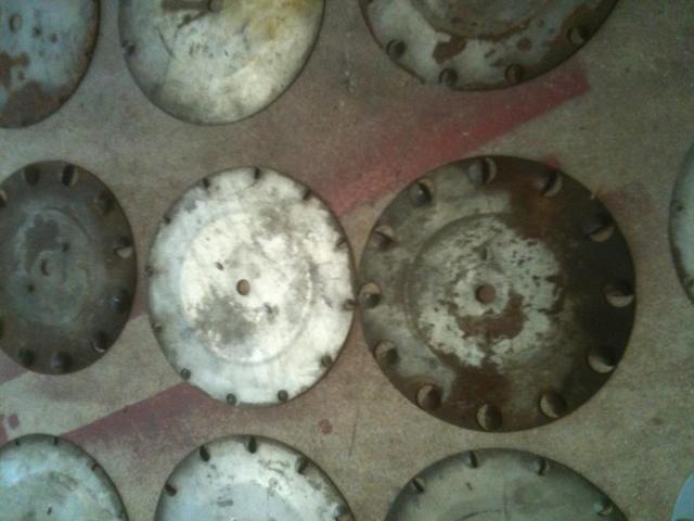

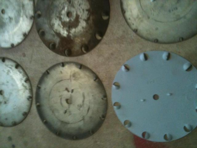

Lane Ranger 11,814 #10 Posted June 1, 2014 Here are some pics of my seeder's plates ! You can see the size variation on the "cups" that grab the seed as the plate turns in the seeder! 1 Share this post Link to post Share on other sites

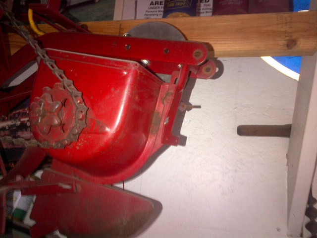

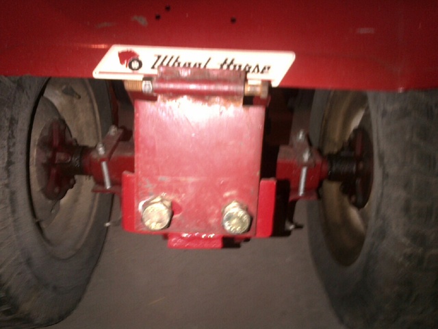

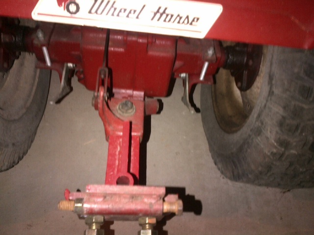

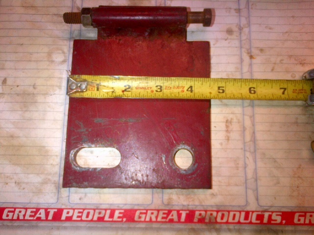

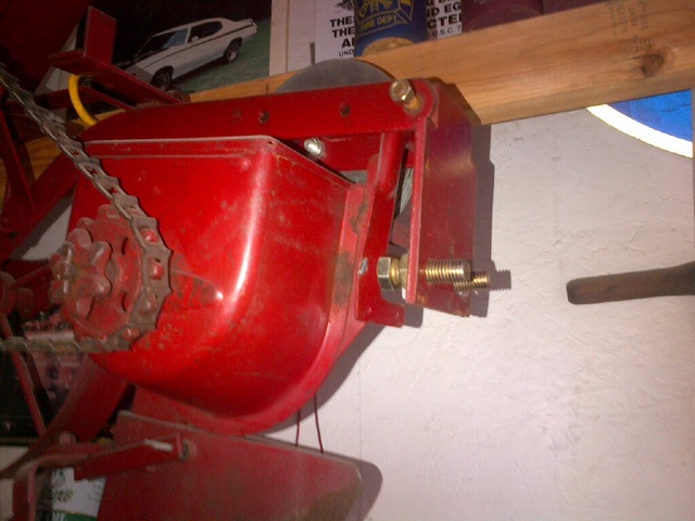

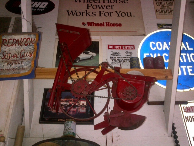

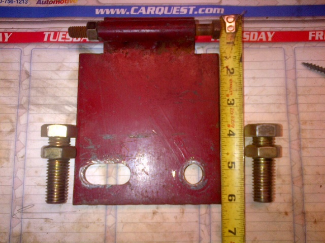

c-series don 11,461 #17 Posted June 10, 2014 Ok here are the pics of my seeder and mounting plate. This plate bolts to the Clevis hitch. I have made an adaptor to go from sleeve to clevis hitch. More pics coming in next post. File was too big to post all at once. More pics 1 Share this post Link to post Share on other sites
c-series don 11,461 #18 Posted June 10, 2014 Actually I was able to post all at once. I hope this helps . Share this post Link to post Share on other sites
jwl 75 #19 Posted June 10, 2014 Actually I was able to post all at once. I hope this helps . I'm pretty sure this will help someone, as now there are two separate posts of guys with this seeder. Thanks for standing up and putting the pictures in of the missing parts. Share this post Link to post Share on other sites
ricksrj58 273 #20 Posted June 10, 2014 (edited) thank you again.these pics will help. Edited June 10, 2014 by ricksrj58 Share this post Link to post Share on other sites
