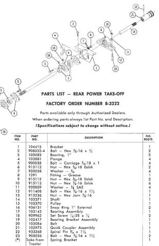

pfrederi 19,941 #3 Posted May 24, 2014 You didn't get all the parts...you need items 21/22 on this picture Share this post Link to post Share on other sites

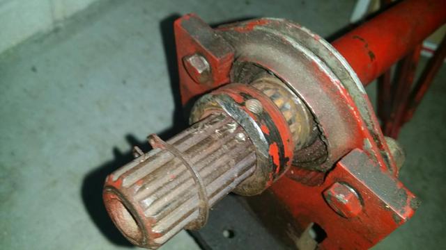

Marv 994 #4 Posted May 27, 2014 Here is pictures of the part you need. Share this post Link to post Share on other sites
