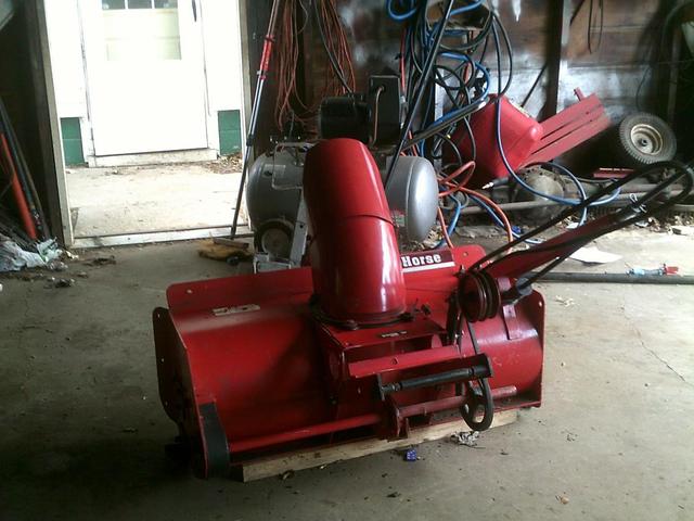

illinilefttackle 399 #1 Posted May 22, 2014 (edited) Hey Guys- just had a member ask me if the snow blower I'm selling in the classifieds would fit his C-175. It was used on my C-125. I told him the tractors are the same except for the engine-so it should- What do the experts say? Thanks-Al Edited May 22, 2014 by illinilefttackle Share this post Link to post Share on other sites
rexman72 210 #2 Posted May 22, 2014 it will work on a c 175 in my opinion 1 Share this post Link to post Share on other sites

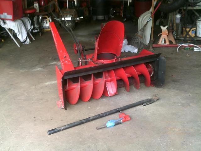

gwest_ca-(File Mod) 11,759 #3 Posted May 22, 2014 Looks odd.for a C-Series snowthrower. What is the model number and serial number? Looks like the ID plate behind the chute. Garry Share this post Link to post Share on other sites
illinilefttackle 399 #4 Posted May 22, 2014 (edited) Sharp eye Garry- it came to me as a #06-37SK02- made for a vertical engine tractor- I converted it to work on a Horizontal engine tractor-making an attachment that fit into the Tachamatic in front of my C-125. Then because it was designed to run backwards of what a horizontal engine blower does-I ran the belt going to PTO on my C-125-thru a "Mule Drive" to reverse it-problem solved-really throws the snow! Edited May 22, 2014 by illinilefttackle Share this post Link to post Share on other sites
gwest_ca-(File Mod) 11,759 #5 Posted May 23, 2014 Nothing wrong with that. Should work just the same. Garry 1 Share this post Link to post Share on other sites
bmsgaffer 2,054 #6 Posted May 23, 2014 Will hook up with no modifications. THe only picking point is that the pto could be in a slightly different position making for a different size belt requirement. Assuming there is a tensioner built in to the system Ill bet it would fit as is. 1 Share this post Link to post Share on other sites
