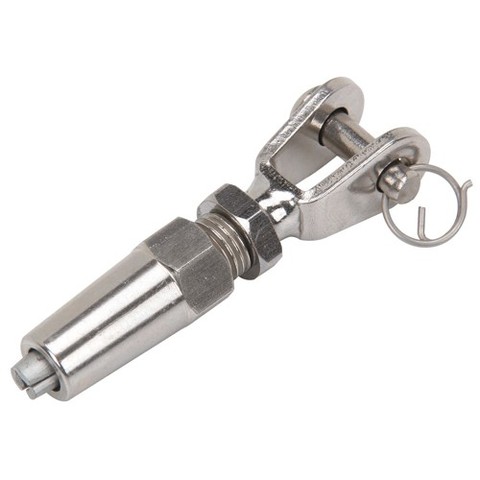

brandonozz 168 #1 Posted May 22, 2014 I've seen several questions (and as many ideas) about how to make your own lifting cables for our horses lifts. Searching the net tonight for something completely different I came across these end fittings for cable of all different sizes. I have no idea what the fittings cost or pull capacity but I would think they ought to handle what we would use them for. Looks like a very compact clean setup for those that need or want it. http://www.hayn.com/marine/tech/himod/install.html The site has a video of how to install the fittings as well. Share this post Link to post Share on other sites
KC9KAS 4,745 #2 Posted May 22, 2014 That looks very strong, simple but strong! 1 Share this post Link to post Share on other sites
squonk 44,975 #3 Posted May 22, 2014 McMaster-Carr has them too. About $25.00 ea. 1 Share this post Link to post Share on other sites

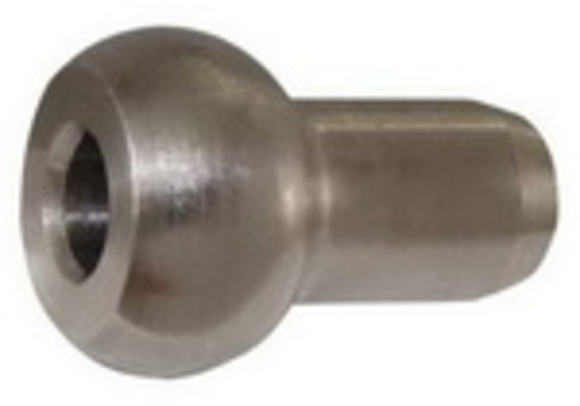

rmaynard 16,718 #4 Posted May 22, 2014 Not to hijack the thread, but does anyone have a tool for installing this type of end on a cable? Neighbor gave me a bag of these and I thought I'd make up a couple stainless steel lift cables if I could find a portable swaging tool. Share this post Link to post Share on other sites
squonk 44,975 #5 Posted May 22, 2014 I have a swaging tool like they sell at Lowes Bob. Looks like a bolt cutter. http://www.lowes.com/pd_348539-258-ST18BK_0__ Share this post Link to post Share on other sites
rmaynard 16,718 #6 Posted May 22, 2014 Tried that one. Doesn't work with this type of end. Share this post Link to post Share on other sites

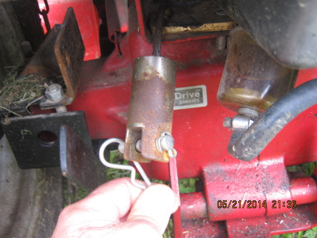

lobo 22 #9 Posted May 22, 2014 Hello everyone, I got this item, with the help from one of our members, from Harbour Freight. The item # is 96889, it fits 3mm wire rope, which they also have, and I have had it on my tractors for over a year and it has preformed excellent, and the cost, are you ready? $5.99. Don't know if you can order on-line, but if you can't and you don't have a store near you I would be glad to help you in any way I can. Good luck and hagd 2 Share this post Link to post Share on other sites
KC9KAS 4,745 #10 Posted May 22, 2014 lobo, I saw a couple of these at work some time ago but never found out where they came from. When I 1st saw them, I knew that would work for our cables on our WH's Thanks for the insight on where to get them. Share this post Link to post Share on other sites

rmaynard 16,718 #13 Posted May 23, 2014 I'm headed to my local Harbor Freight (74 miles round trip) on Thursday. That's when they are supposed to be restocked on the 96889's. Seems like a reasonable alternative to my having to get a $400 press to install the ball type swages. Share this post Link to post Share on other sites
