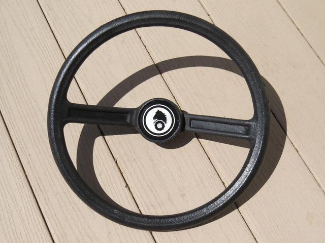

rustykan 140 #1 Posted May 22, 2014 Any secret tips for restoring the steering wheel on a C-120? Mine is in pretty good shape, but was wondering if there is any way to make it look better. Share this post Link to post Share on other sites
rmaynard 16,700 #2 Posted May 22, 2014 Soft wheel or hard plastic. Share this post Link to post Share on other sites
rustykan 140 #3 Posted May 22, 2014 I would say it is hard plastic. Share this post Link to post Share on other sites
bmsgaffer 2,065 #4 Posted May 22, 2014 That's actually the 'soft touch' wheel. The hard plastic are shiny and thinner. Share this post Link to post Share on other sites
rustykan 140 #5 Posted May 22, 2014 Learned something new! Share this post Link to post Share on other sites

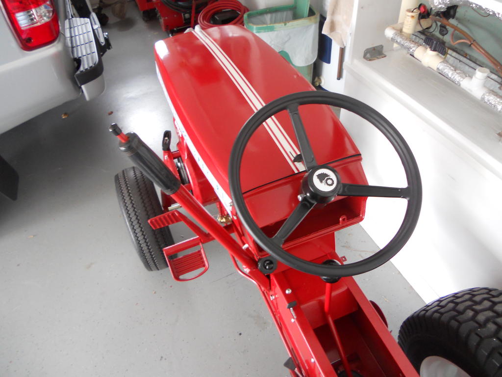

Racinbob 12,432 #18 Posted May 30, 2018 I've done a few. I repaired any major dings with JB Weld, painted the spokes with Krylon for plastic and coated the rim with Dupli-Color truck bed liner. It looks and feels great and is as durable as most anything. 2 4 1 Share this post Link to post Share on other sites
Skipper 1,790 #19 Posted June 4, 2018 (edited) Bob, that bedliner solution is good thinking (don't want to say brilliant in public) Strong, wear resistant, and with the right looks and feel. Perfect! Do you mask it off like any other spray paint? I'm so gonna steal that idea............ Edited June 4, 2018 by Skipper 2 Share this post Link to post Share on other sites
Racinbob 12,432 #20 Posted June 4, 2018 I paint the spokes (if needed) without masking and then mask off the spokes for the bedliner spray. 1 Share this post Link to post Share on other sites
